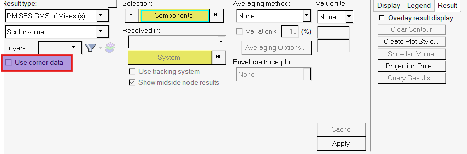

Does anyone have any idea to check through Hyperview API, the list of results where Corner data can be enabled?
If you don't have the result of type "by element by node" I don't think you have this option.

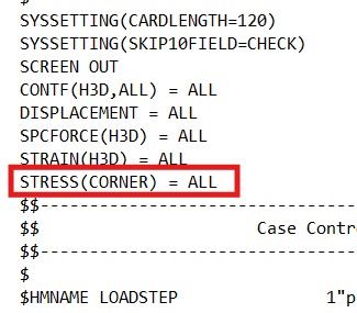

Hi @Ajay Prabhakaran ,
To view corner results in HyperView, you need to request corner data for the entity of interest during the analysis. Once this request is included, you will be able to review the corresponding corner results in HyperView.
Hi , you can use "poIContourCtrl GetCornerDataEnabled" to get the corner data state.
Detail info :
https://help.altair.com/hwdesktop/hwd/topics/reference/tcl/poicontourctrl_getcornerdataenabled.htm
