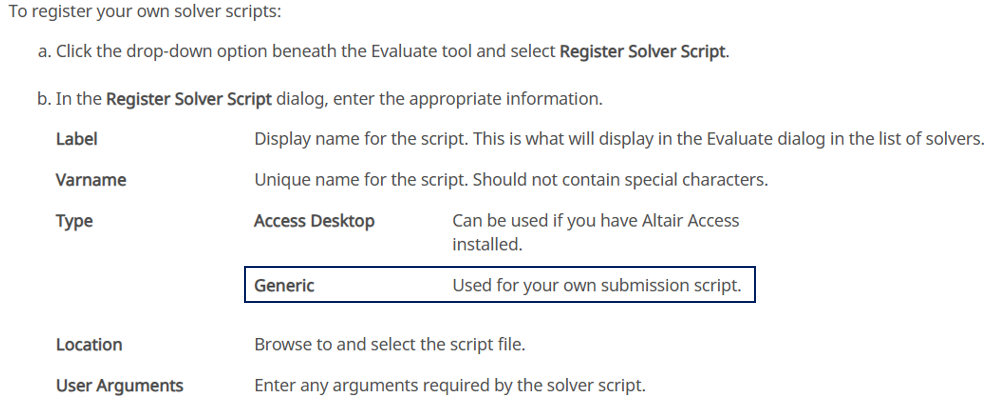

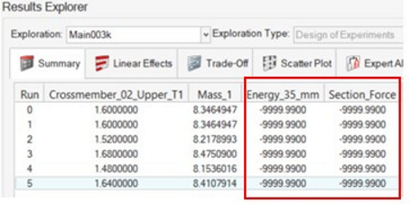

I am using Design Explorer to execute LS-DYNA simulations on a remote machine. My workflow involves initially setting up the exploration on my local machine and then running the simulations on the remote desktop.
I am looking for guidance on how to properly create and register a solver script to manage this process for Windows.
Any advice or example scripts would be greatly appreciated. Thank you.
