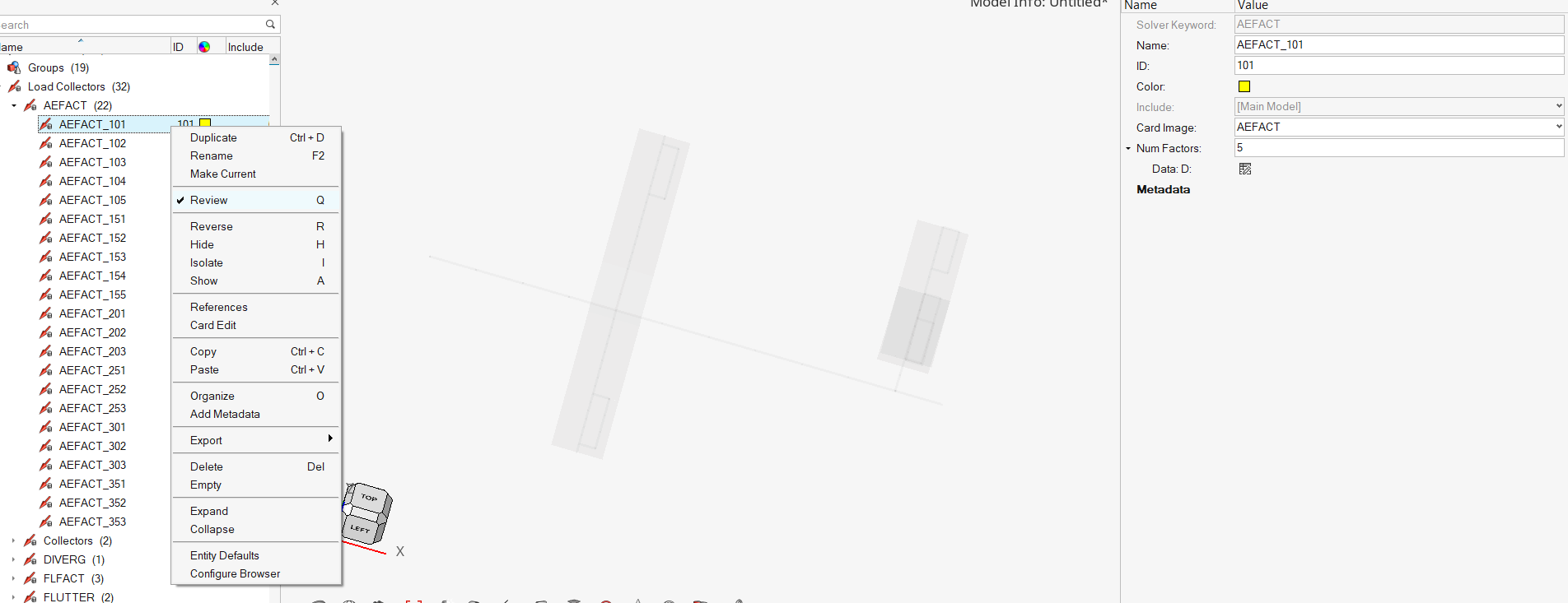

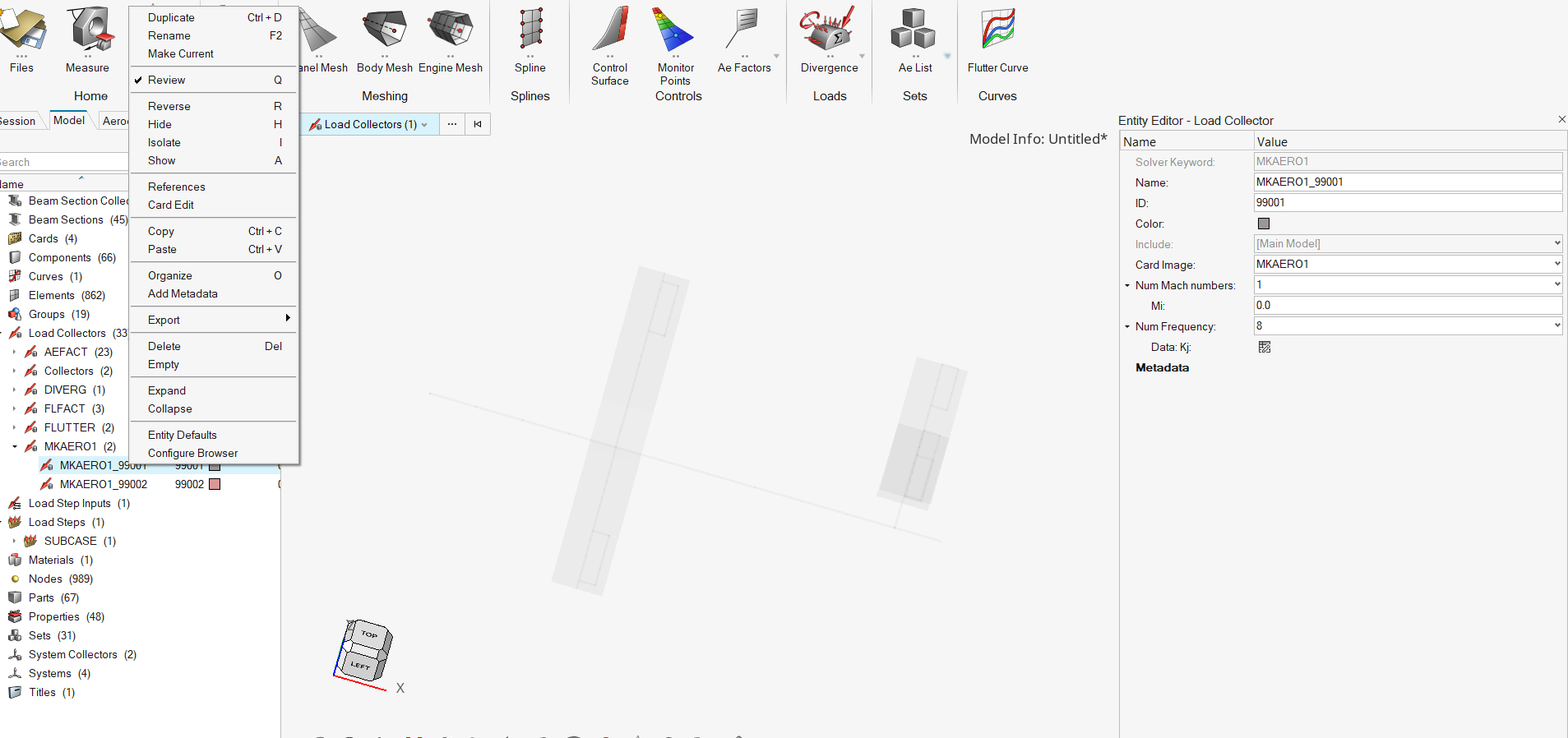

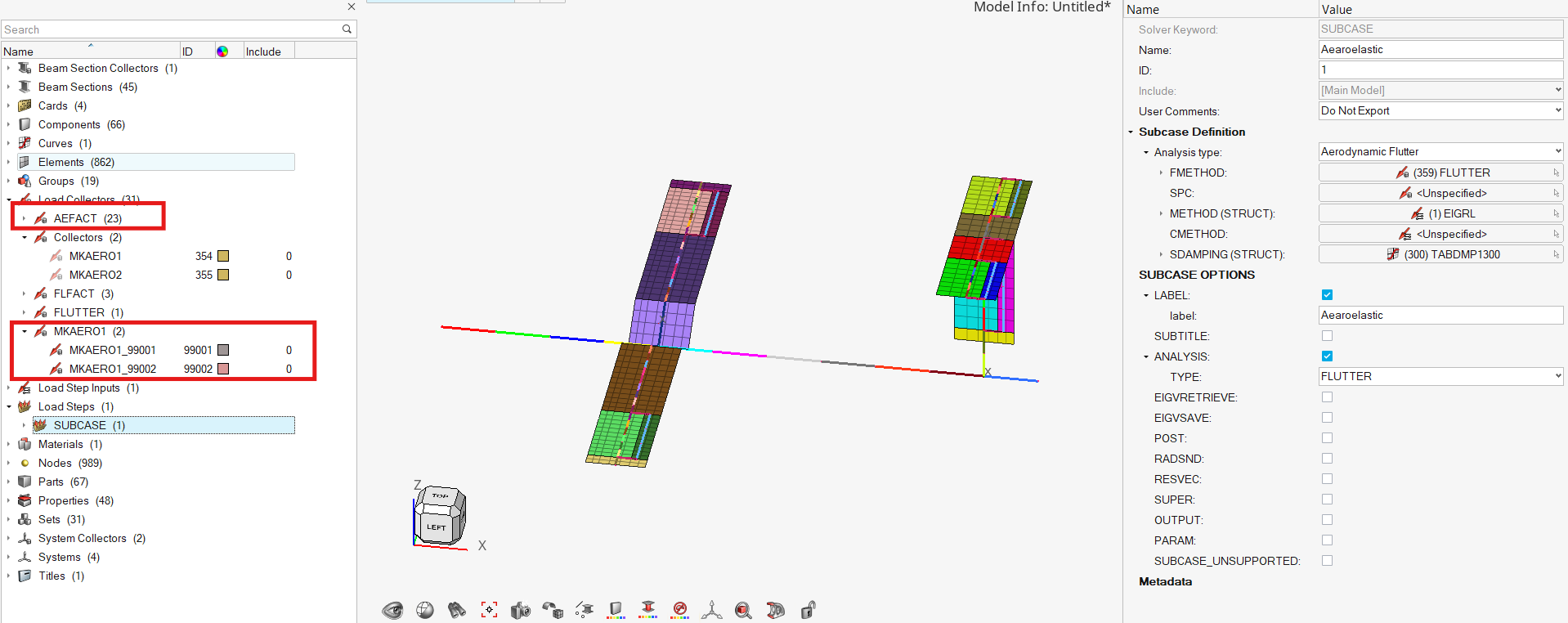

Dear Team, I wants know how to create AEFACT & MKAERO1 card and how it referrence to the model to the load step (because loads like AEFACT & MKAERO1 card did n't mentioned in load steps) ? And need more explaination about AEFACT & MKAERO1 cards how it works? i try to review it , but it did n't work!
OS-T: 8030 Flutter Analysis of a General Transport Aircraft Model
Hello,
You can find useful information in the following discussion:
