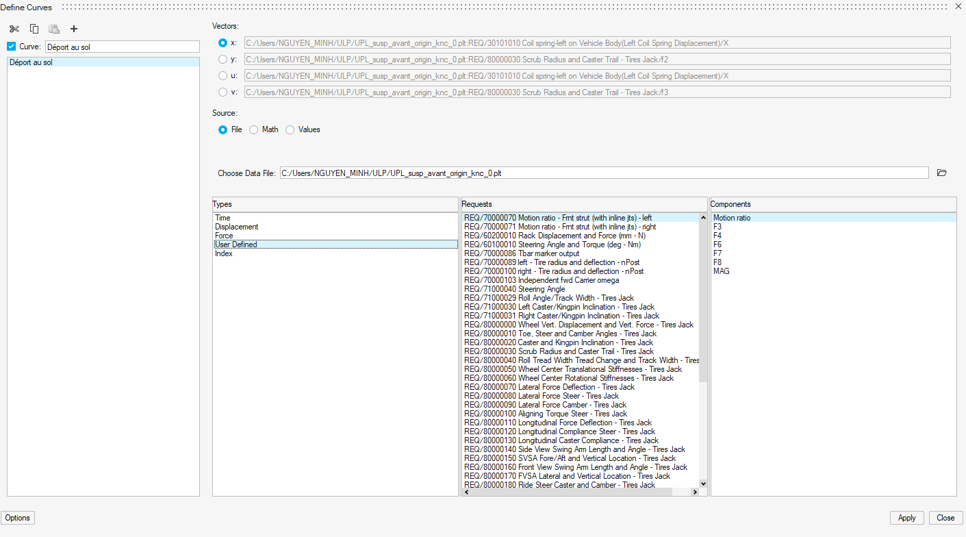

hello, How I can find the definition of request output in Motionsolve? Can I add some personal requests?
Hello @NGUYEN_MINH,
The outputs that you are looking at are default outputs created based on User-defined function for KnC event by the solver. You can also create your own outputs as required. Please refer to the below link for more details and the steps:MV/MS Intro eLearning - Ch4 1 Outputs Attaching the documentation link aswell for more details: https://help.altair.com/hwdesktop/hwx/topics/motionview/outputs_r.htm Hope this helps!
Thank you for your answer. Can I find the definition of these default outputs?
Here is the link for SDF output definitions. https://help.altair.com/hwdesktop/hwx/topics/motionview/sdf_output_in_plt_file_r.htm?zoom_highlight=sdf
thank you very much
