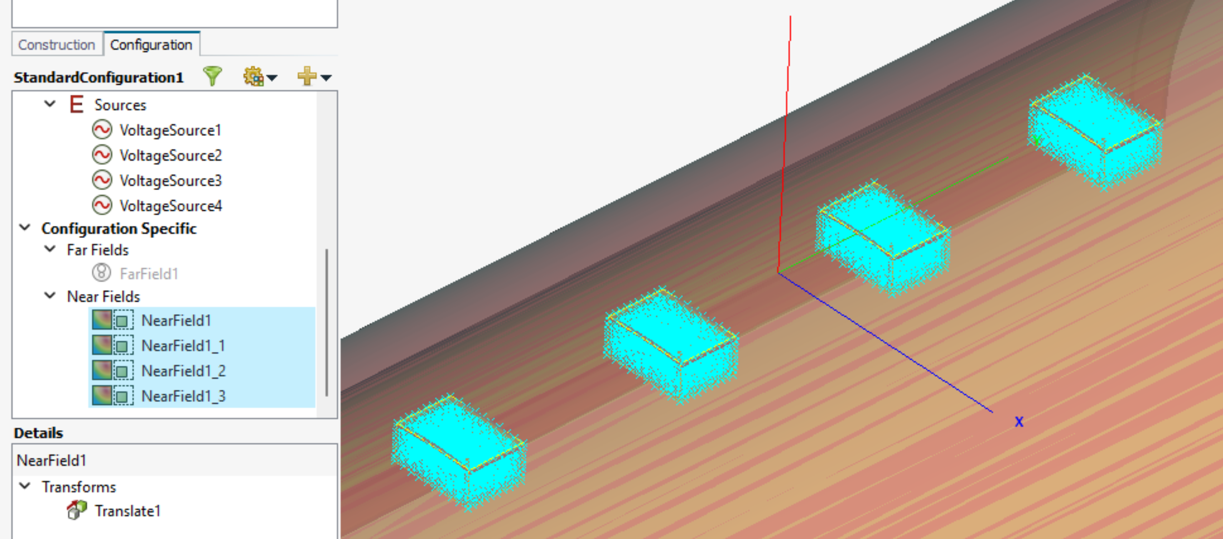

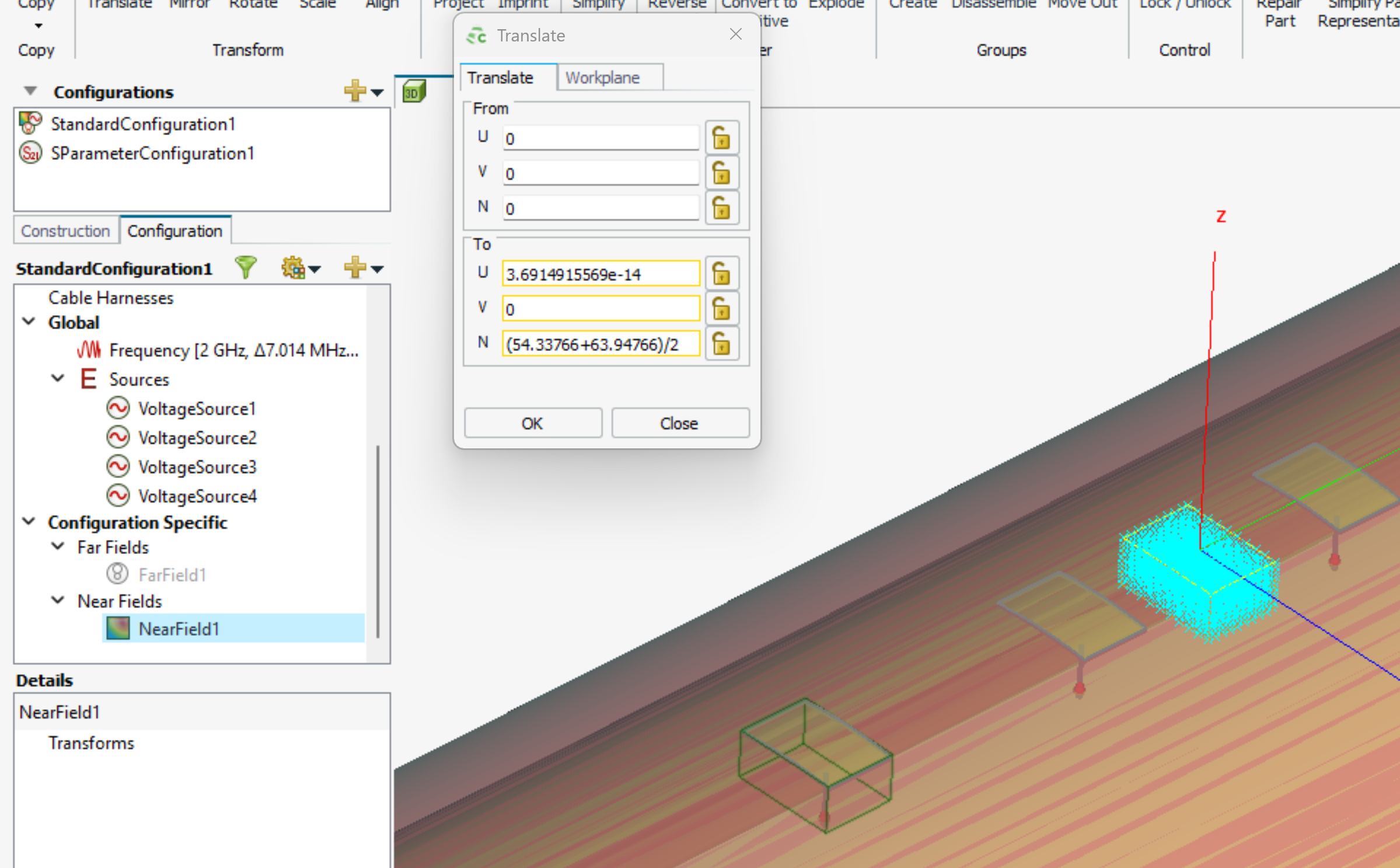

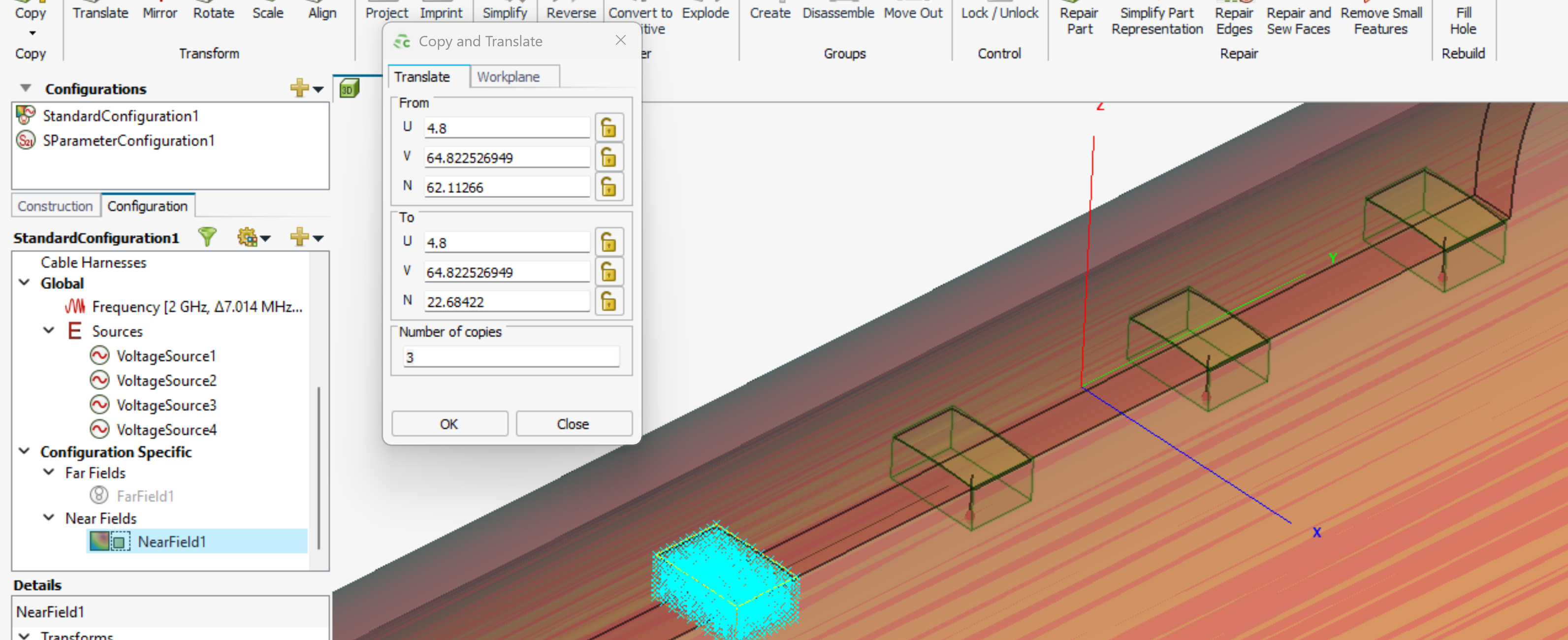

@sswh2 you should be able to move the Near Field request by performing a Translate operation. Once that is under a patch, you can then perform Copy and Translate to copy and create and then move the Near Fields under the other patches:
Is this what you were looking to do?
Glad I could help with your issue!
@Evan_Urban sir Thank you so much!, yes this is the one I wanted.
