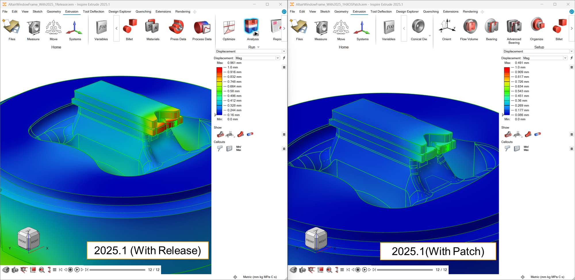

An issue was identified in Inspire Extrude 2025.1, where the FEM deck generated for HXOS couple analysis was applying the same load twice on certain surfaces.
This duplication could cause artificially increased deformation and stress values in the simulation.
