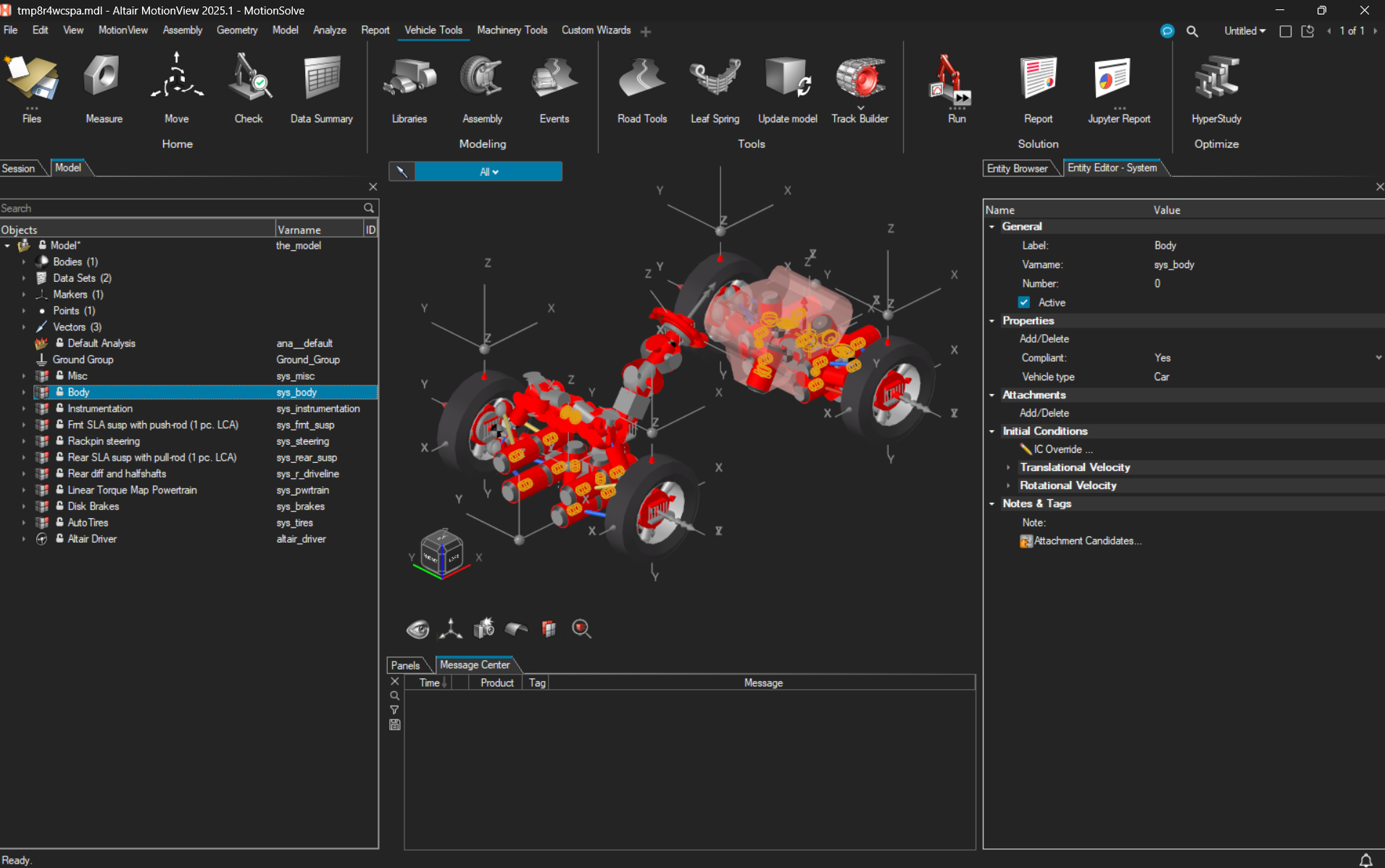

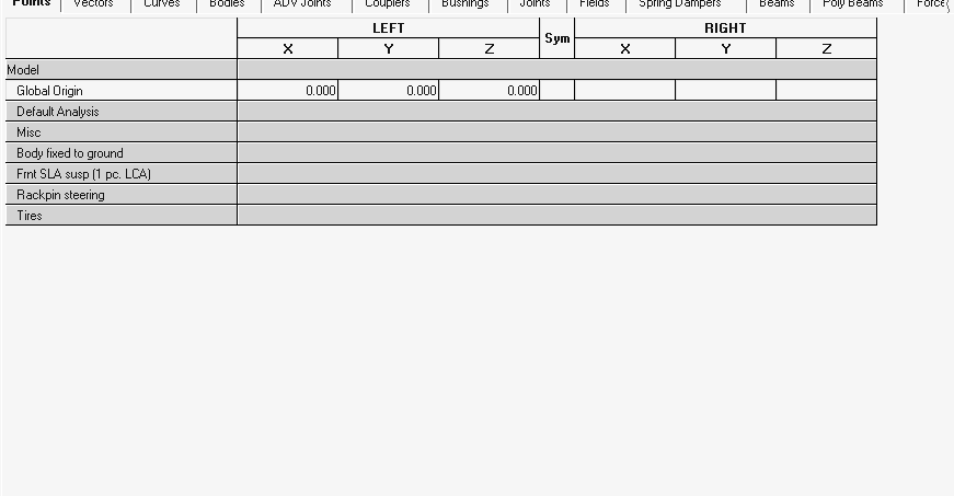

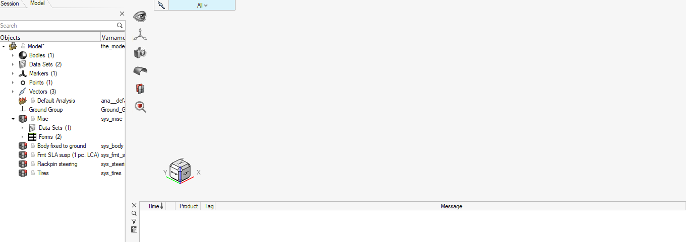

Hi, I downloaded the BAJAfsae template file provided by Altair, but when I open it, nothing appears, although there are items in the project tree. Furthermore, even though I have the components, when I access the data summary, nothing appears. I followed the steps in the article, but I can't solve the problem. Link for the article: https://community.altair.com/discussion/36055/baja-and-fsae-library-overview-in-motionsolve?utm_source=community-share

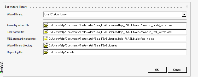

Hello @fritschefelipe23, as @Christopher_Fadanelli pointed out in the community post, your Wizard library directory misses one level. It should be
"C:/Users/felip/Documents/Testes altair/Baja_FSAELibraries/Baja_FSAELibraries" Hope this helps! Best regards, Orestes

I redownloaded the extension and tested this in version 2025.1 of MotionView without any issues:
What version are you using?
In rare cases, you may need to reset your graphical preferences. Please run the HWCleanup Tool to reset HyperMesh Desktop preferences and repair interface graphics
(C:\Program Files\Altair\2025.1\hwdesktop\utility\HWCleanup\HyperworksWindowsCleanup.bat)
Hope this helps!

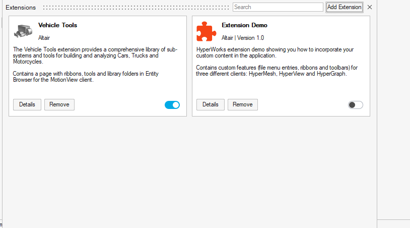

Hi, you say the vehicle tools extension? And i could redownloaded? Please. And run the HWCleanup Tool and not solve.
I am referring to the Baja FSAE libraries, not the Vehicle Tools Extension.
