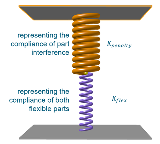

The reasoning behind this approach is straightforward: restitution is primarily governed by the elastic deformation of the contacting parts, not by the contact method itself. The contact can be conceptualized as two springs in series as shown below.
The lower spring represents the physical compliance of the flexible body, while the upper represents the penalty stiffness. The equivalent stiffness is
To ensure that the total repulsive force is dominated by the actual deformation of the structure (rather than artificial compliance introduced by the penalty term), the penalty stiffness must greatly exceed the structural stiffness, K_penalty » K_flex
. Let's assume that K_penalty = 10^3 * K_flex
, then we easily see that the equivalent stiffness is
This same principle can be applied in multibody simulations by replacing rigid bodies expected to undergo contact with flexible body representations. Multibody tools like Altair MotionSolve are particularly effective at handling contact interactions involving flexible bodies, allowing for more accurate and physically meaningful simulation of contact dynamics.
