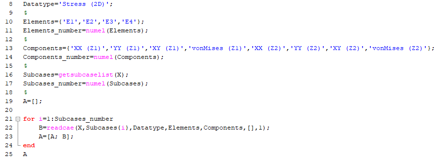

for i=1:Subcases
E_=readcae(X,Subcase_List{i},'Stress (2D)',Elements,{'XX (Z1)','YY (Z1)','XY (Z1)','vonMises (Z1)','XX (Z2)','YY (Z2)','XY (Z2)','vonMises (Z2)'},[],1)
end

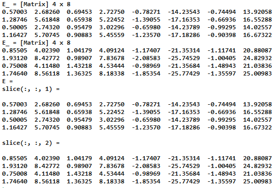

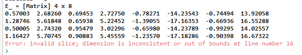

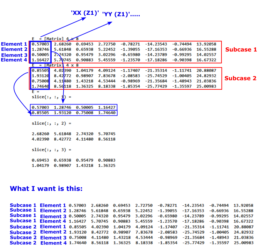

At the end of each iteration I get a submatrix with all the requested components ('XX (Z1)','YY (Z1)', etcc…) in columns and elements in rows for each subcase.
I need to store this submatrix for each iteration, hence for each subcases.
Is there a way to get it?
