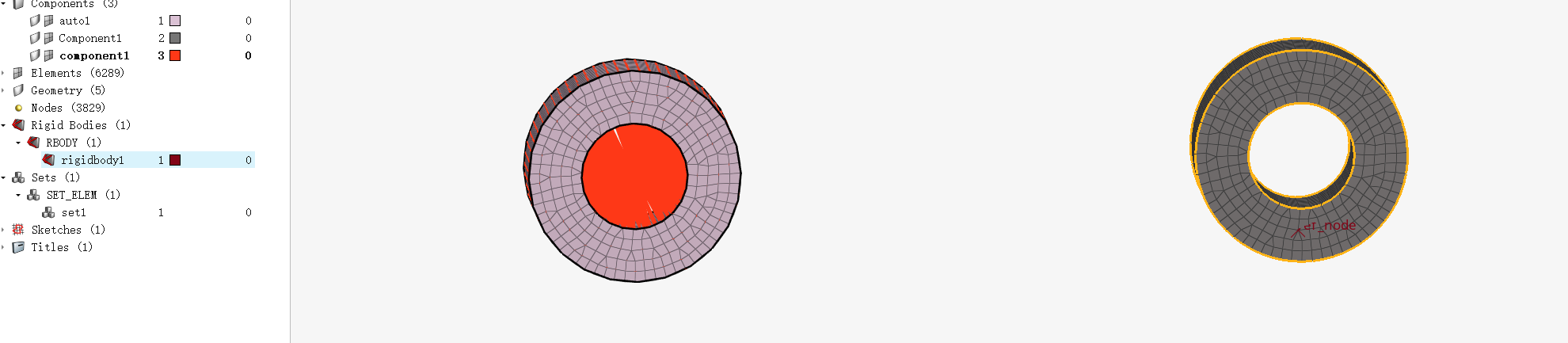

The first method is to couple the degrees of freedom of all nodes at one point through Rbe2; The second method is to create rigid bodies through Rigidbody cards. Which one is suitable for contact analysis? I have tested and found that the convergence performance of the first method seems to be easier than the second method in contact analysis. Can any expert explain in detail the characteristics of these two creation methods and their suitability for different working conditions?
