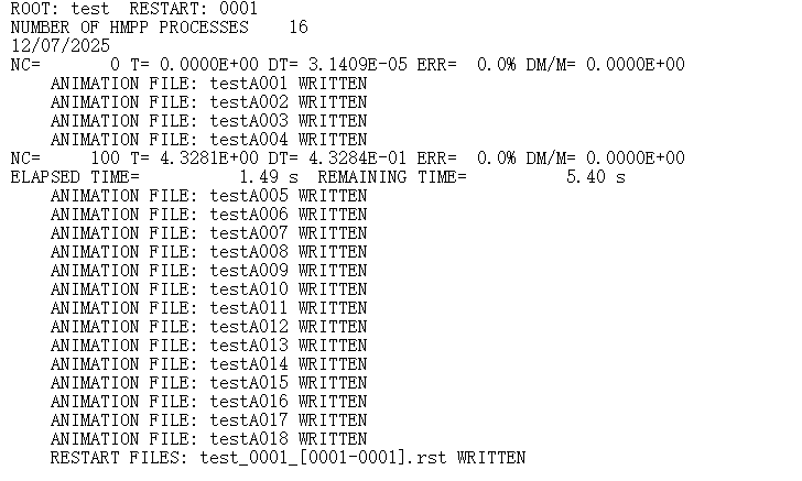

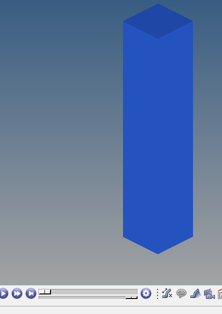

In Hypermesh I set a beam with 10*10*50, fix one end and exert displacement of 5 on the other end. Then I apply this hyperelastic material after compiling it into lib. Now the radioss log shows like this

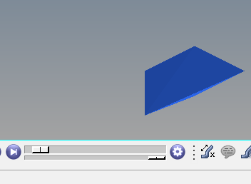

And the results turned out that the beam didn't stretch but immediately squashed like this
Could anyone could help me to figure it out?
