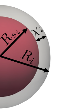

I am trying to create a contact model which simulates the melting of a particle. My idea is to realise the following:
- A particle is initialised at 12mm. Its contact radius and both physical radius are set to 12mm.
- During simulation, shrinkage is applied based on temperature of the particle. The idea is that only the physical radius should be changed. The contact radius should remain 12mm to represent the molten layer. The difference between the physical radius and the contact radius can then be seen as a molten layer surrounding the core of the particle. A contact should remain registered between particles (calculateforce() triggered)  if molten layers interact. See image below.
Source: https://research.utwente.nl/en/publications/numerical-and-experimental-studies-of-laser-powder-bed-fusion-pro
Now, this would allow me to define a contact model that calculates forces when the molten layers of two particles start to interact i.e. when we start to have positive contact radius overlap. Then, once the physical unmolten core of the particles interact I will have additional hertz-mindlin elastic contact forces. Effectively, this allows me to create a cohesive model for partially molten particles.
The problem I am phasing is combining shrinkage via the setScale together with this representation of the molten layer. For this to work I need the solid core to keep shrinking but somehow keep the contact radius representing the molten layer to remain constant at 12mm. Because, I want the calculateforce() function to be triggered even if the physical particles no longer touch, as long as the molten layers interact. Also, new contacts should be registered if only the molten layers interact.
