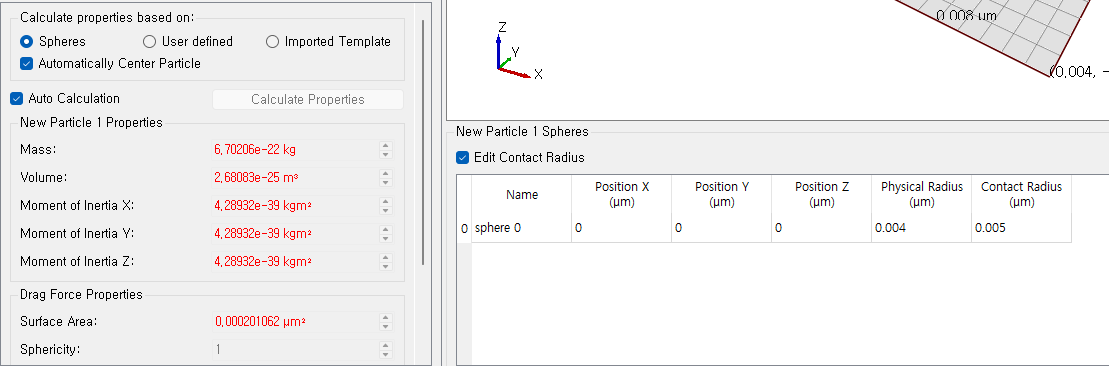

I am now attempting to model DNA structures by connecting spherical particles— which do not require meshing—into meta-particle chains. In the process, I encountered an issue I would like to ask about.
While entering physical properties, I noticed that some values appeared in red text, as shown in the attached image.Could you please clarify the exact meaning of this red text?
- Does it indicate that the value is physically invalid or out of an acceptable range, and that EDEM will automatically adjust it to the nearest permissible value during simulation?
- Or is it simply a warning, suggesting that the entered value is unusually small or outside the typical range, and should be reviewed?
