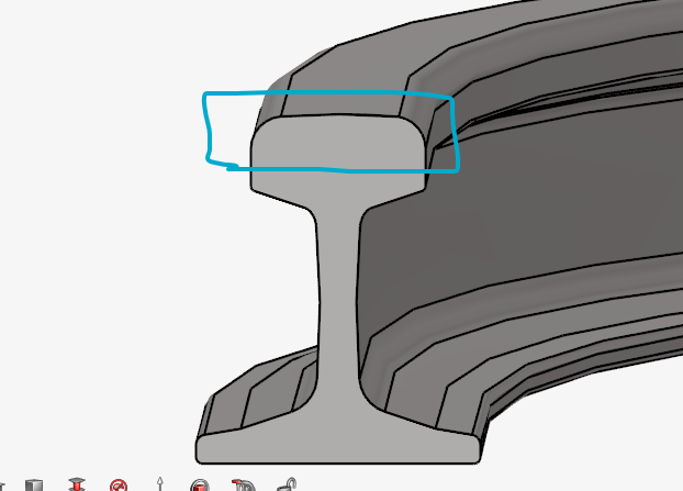

Does the model crash when it is exporting or does the geometry export take a very long time?
The reason can be due to geometry. Since geometry has a contact entity and the overall volume is very large, it needs to be meshed by Motionsolve before the analysis can begin. As you have experienced, this can take a very long time.
A couple of suggestions on reducing the export time.
