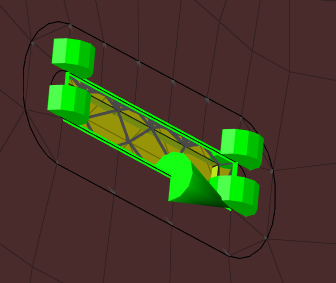

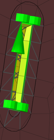

Hi, i am currently using Optistruct, and I am having some issue with the connector modeling. In this photo you can see that the gap between the two surface is not fully filled by the penta mig , it is not an error i think but there may be some problems when i will launch the model because the stress there may be overstimated.
Can you give me some advice please
