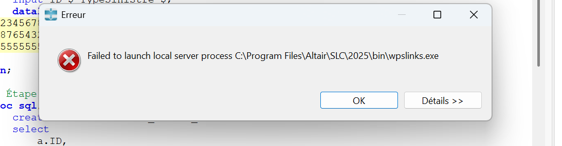

Yesterday it was working.
But since today, I'm getting this error on Altair Analytics Workbench.
I'm using a personal edition.
Hey, Thanks for the answer!
The details only show:
Failed to launch local server process C:\Program Files\Altair\SLC\2025\bin\wpslinks.exe Cannot run program "C:\Program Files\Altair\SLC\2025\bin\wpslinks.exe" (in directory "C:\Users\USERNAME\Documents\Workbench Workspaces\Workspace1"): CreateProcess error=2, The specified file could not be found
I did try restarting my computer several times.
I think the issue might be related to a security feature on my laptop, but I couldn't find any relevant logs.
However, I managed to make it work by creating a batch script that recreates the file every time it gets deleted, and it works.
I noticed that the file gets deleted every time I get an error in my SAS program.

I'm glad to hear you got it working.
