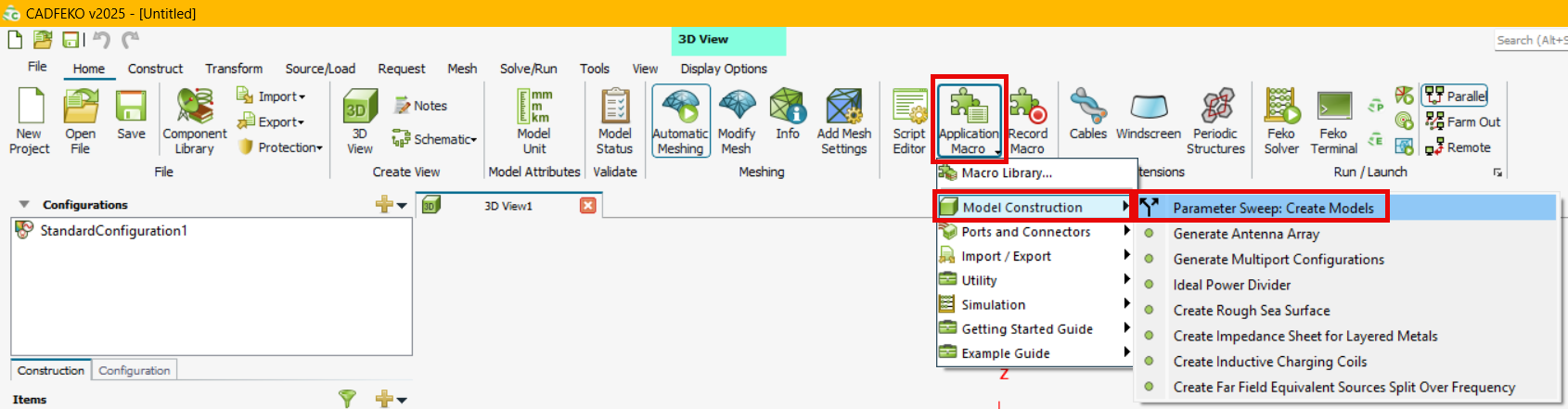

    Hi @GabriB ,
    An alternative to HyperStudy would be the Parameter Sweep in Feko:
    Best regards,
    Torben
