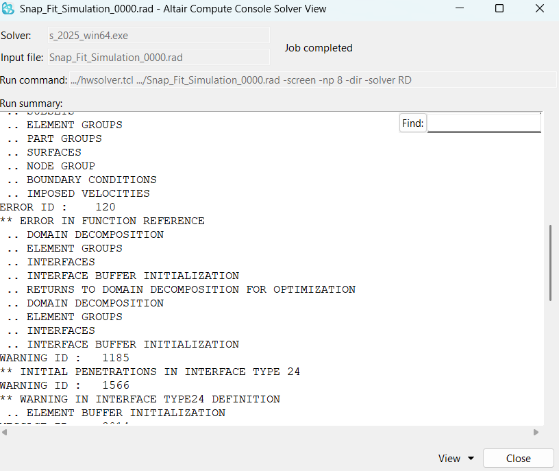

I used Law36 material, Biquad failure model and Contact type24 but I faced this issue as the below picture when I run simulation. Can anyone help me?
by the error message it might be related to some curve/fucntion that was supposed to be called somewehre, as it is missing reference.
Have you performed a model check on your model? Ctrl+F » model checker.
It might help you on spoting your error.
