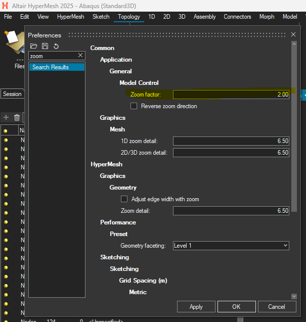

Talking Zoom… Some highly disorganized and disjoint information about our software suggests ALT-RMB micro-zooms or zooms at all WHICH IT DOES NOT! and instead brings up the wagonwheel thingy shown below (actually I should see about learning this; could be useful possibly). The wheel zoom steps are sooooo coarse! and I haven't found something of a *setoption zoom_steps in the highly disorganized and half-hearted pool of tcl documentation. I might not know something, but HOW DO YOU ZOOM A BIT BETTER (finely) and WHAT ABOUT THOSE WITHOUT a Wheel Mouse (and don't say there isn't any without a wheel these days).

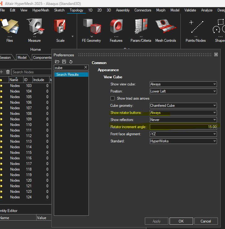

About SN-Clocking(SNClock)…
There exists rotational arrows that get exposed when you hover over the coordinate system Triad icon down left of the workspace. Try pushing on that, as it jerks around in rotation. At least it's there (I swear I looked all over for this function before I found it). The way to control that is, like I mentioned above, where the tcl setting affects BOTH tcl and GUI rotations. But Darn IT!!! it's so cumbersome when one needs dynamicism with different on-the-fly stepping to get certain 3D view to line up upright (for documentation purposes) Absolutely ugly. I wrote a script before that takes two points/nodes and computes screen rotation necessary to orient that vector straight up (thus the decimal places in the tcl command above) What the… (go copy solidworks and/or femap please, Altair!)
