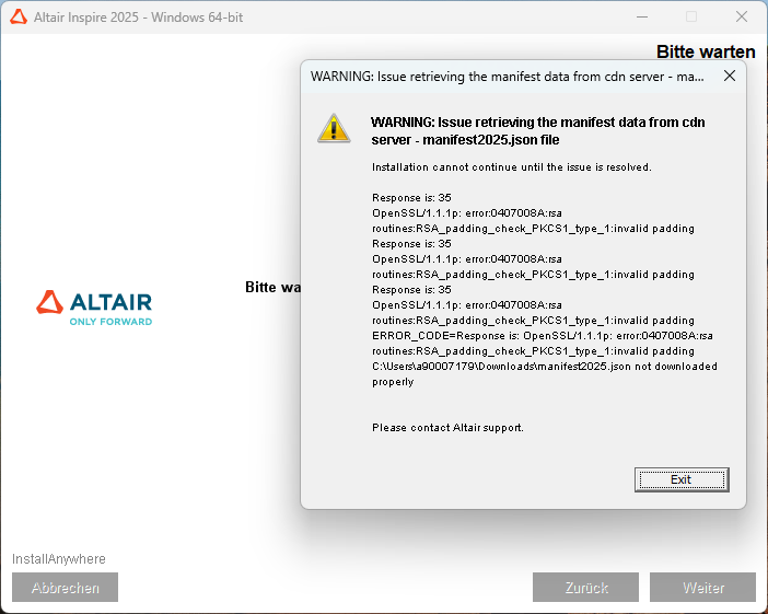

Hi,
i tried installing student package of inspire but i doesn´t work. This issue report shows up when i try to install.
Can you help me with this?
Thank you

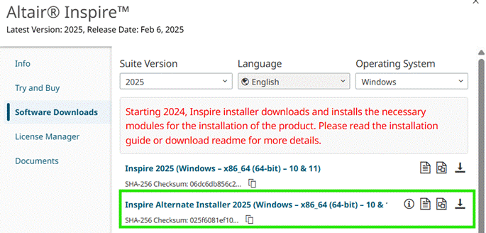

Please note that there is an alternate installer that you can use if unable to install Inspire with the regular installer,
You just need to uncompress the alternate installer and run the AltairInspire2025 installer within,
