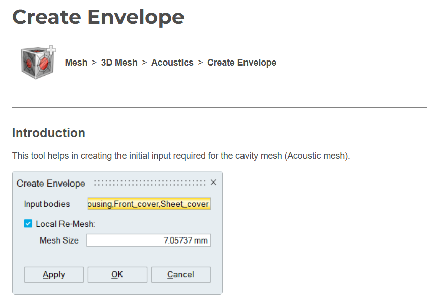

I am trying to build a acoustic model.
In SimLab's help, we can see the description of "Create Envelope", but I can't find this GUI in SimLab (v2025).
Is there any environment variable that I should set first?
Thank you.
