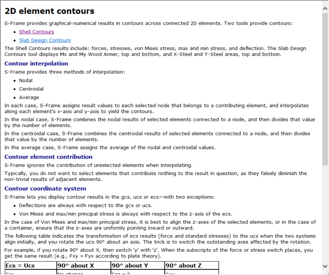

Information about the 2D Element results (Shells and plates) can be found on the Help system, available through the menu Help—>Content
This will toggle the Help system, where you can write any topic and search for it; in this case, the topic you are looking for is the 2D Element Results,
Specifically related to contours, for example;
My advice is to browse this section and get back to us if you require any further assistance.
