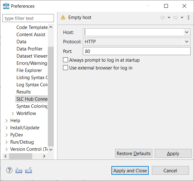

I followed your suggestion to add one more line on workbench.ini and it is still not working.
There is a message showing 'No hub connection configuration'.
