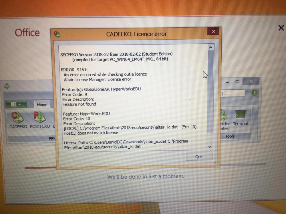

Apparently the installation was OK, but when trying to run the FEKO software, a License error is displayed. Any hint on how to solve this:
(I followed the instructions given in the email)

Use windows folder options > unhide known extensions, to make sure the file is named altair_lic.dat and not altair_lic.dat.dat,
You need to confirm if the Ethernet address in the license file is the correct one and matches the one in your machine.
When you open the license file in a text editor you will see an Ethernet address there in a line that says 'ETHERNET =
The Ethernet ID is the ID of your machine which is exactly 12 hexadecimal numbers. For example D4WRF478F398
Run ipconfig/all in command window and check for physical address under Ethernet adapter local area connection:
The listed physical address under Ethernet adapter local area connection should be used to generate the license file, if there is no listing of Ethernet adapter local area connection, the address under Wireless Adapter LAN Wifi must be used.
That means if the address provided as above does not match the one in the license file, please request for the license file again with the correct Ethernet ID.
You can check your computer’s Ethernet address, by using the almutil -hostid application from the Start > Altair > Tools > Admin tools Menu and compare it with the result in the command window,
Alternatively run getmac in command window to find out available Ethernet addresses to cross check as well,
I am having this same issue. I have found that my Ethernet physical address does not match the license file sent to me. What steps do I take now?
The listed physical address under Ethernet adapter local area connection should be used to generate the license file, if there is no listing of Ethernet adapter local area connection, the address under Wireless Adapter LAN Wifi must be used. request here https://studentedition.altair.com/ with the right ID,
I followed your step to find the Ethernet and requested a new license file. I used the physical address under 'LAN adapter Local Area', which was different from the one I used previously. After I receive a new license file, what steps do I take to ensure the software will run? Will I have to reinstall FEKO?
Just replace the old license file with the new one in the security folder.
