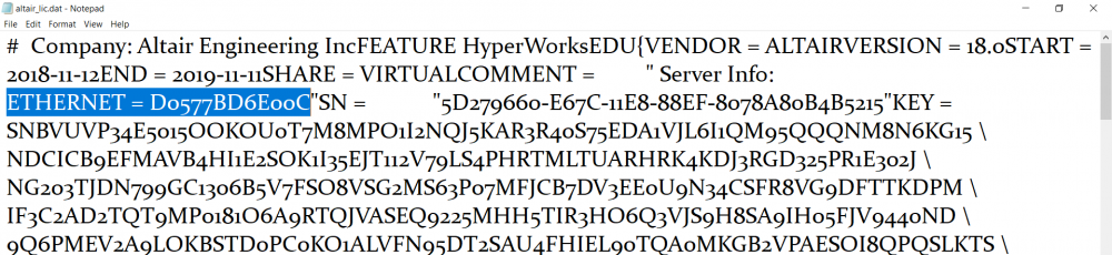

I have got a new license after verifying the Ethernet address. Now they match but still the error is on.

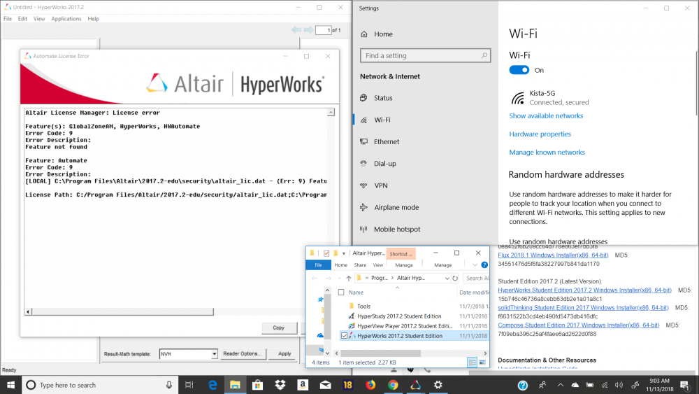

The error:
Altair License Manager: License error
Feature(s): GlobalZoneAM, HyperWorks, HWAutomate
Error Code: 9
Error Description:
Feature not found
Feature: Automate
Error Code: 9
Error Description:
[LOCAL] C:\Program Files\Altair\2017.2-edu\security\altair_lic.dat - (Err: 9) Feature not found
License Path: C:/Program Files/Altair/2017.2-edu/security/altair_lic.dat;C:\Program Files\Altair\2017.2-edu\security\altair_lic.dat

- The Ethernet addresses are matching (see attached)
- old license is with Ethernet adapter Ethernet 2 (picked by your Altair host ID tool) and it gave the same error. (see attached)
- New License is with Wireless LAN adapter Wi-Fi and it gives me the same error. (see attached)

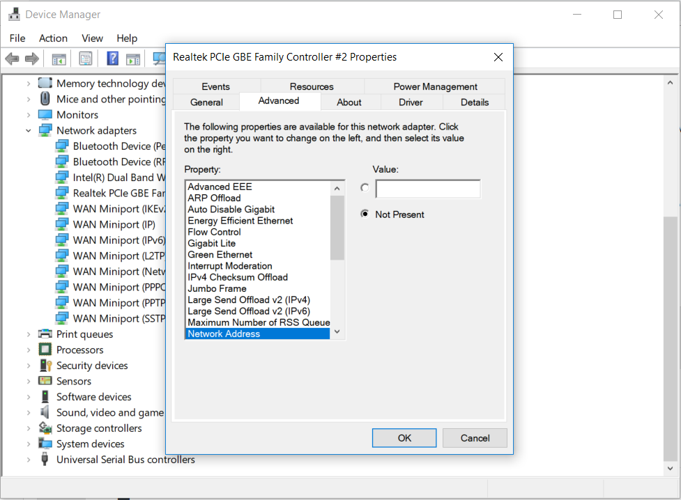

- Network Address is not present (someone said in forum so I checked it - see attached)
