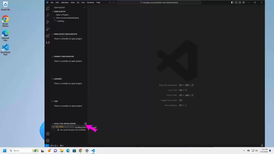

Install the DSim Simulator from DSim Desktop
You can easily install the DSim simulator directly from DSim Desktop. Watch the video:
