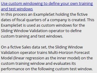

I'll touch on it below, but I wanted to experiment with other time series validation methods and have been looking into the SWV operator's Custom Windows parameters. I based my attempts on the Custom Window tutorial process:

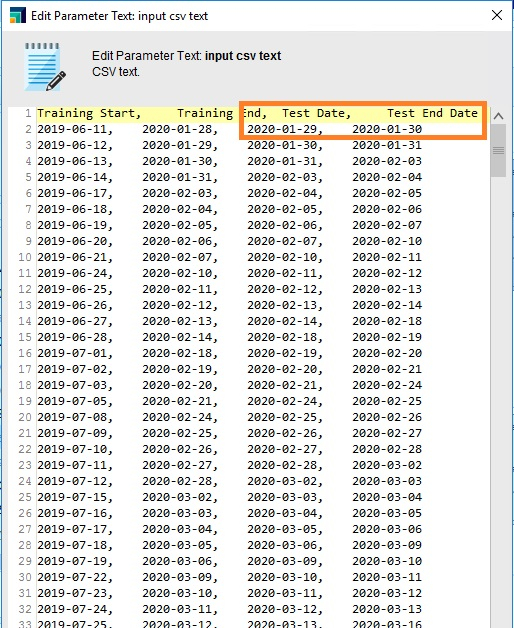

Following the tutorial process, I created an Example Set with Dates to replicate the "basic" parameters:

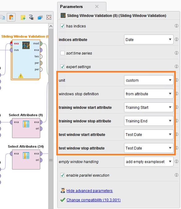

I connected that Example Set to the SWV operator's "cus" input port and I configured its parameters thusly:
[NOTE: Since my Test Window is a single observation wide I used the same attribute (and date) for the Test Window Start and Test Window Stop values.]

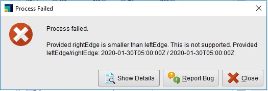

An error was thrown:

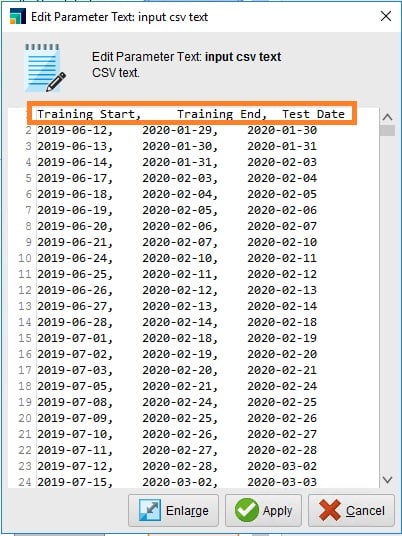

I tried a different Example Set for the Custom Windows:

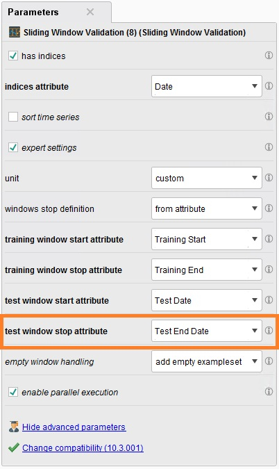

and slightly different parameters for the SWV operator:
Of course, the question with this approach is whether or not the Test Window is now 2 observations wide (more on that later)...
The following happened... The results using this revised SWV operator configuration were different that the "basic" ones I detailed above.

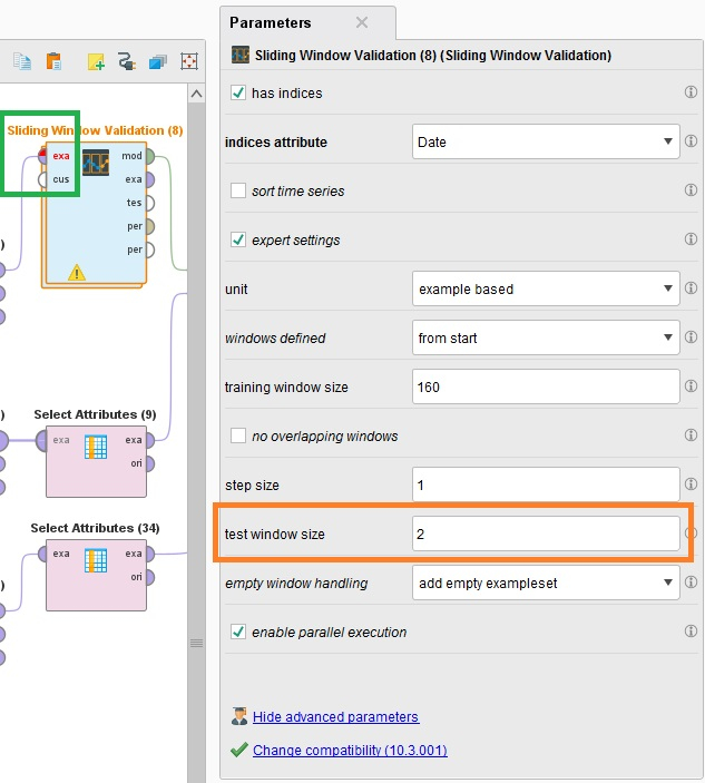

In addition, the results were different than configuring the SWV operator to have a Test Window Size of 2 (like below):

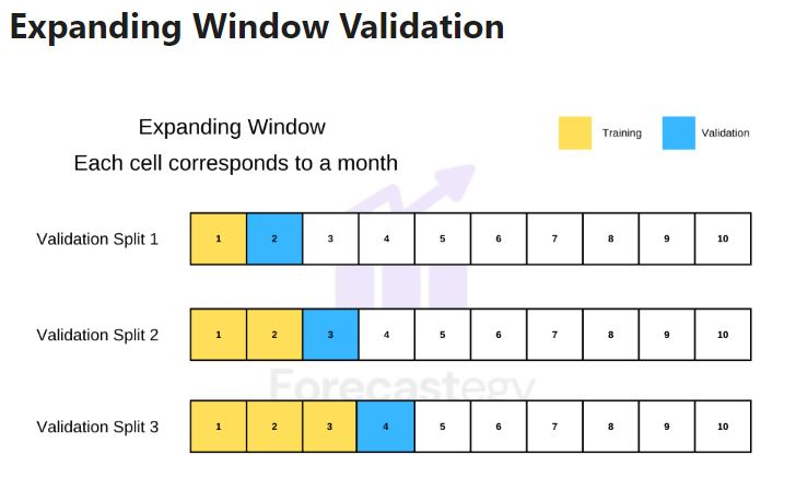

===> In addition, I'm trying to implement a so-called Expanding Window Validation (see below). Can this be achieved with the SWV operator and can someone please help me get moving in that direction?
