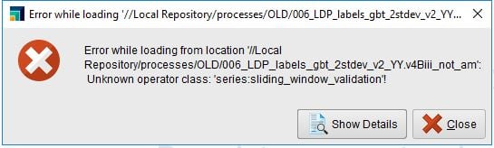

I'm doing an analysis that is similar to one I did waaaaay back in 2019. I tried loading a process from that old project and am getting the following error:

Hi @Noel_D,
did you install series extension? Your process seems to use it. If i am not mistaken thats the old ts extension which isnot bundled and needs to be installed manually from marketplace.

Hi @Noel_D ,
the switch happened somewhen in RM8, so it was years ago. The series extension is still available on marketplace: https://marketplace.rapidminer.com/UpdateServer/faces/product_details.xhtml?productId=rmx_series
Its mainly there for compatibility reasons. The bundled operators should have all the functionality in a more user friendly, more robust and faster manner.

which version of Studio are you running? I tried loading the process, it loads fine (albeit replacing the unknown operators with Dummy ones):
