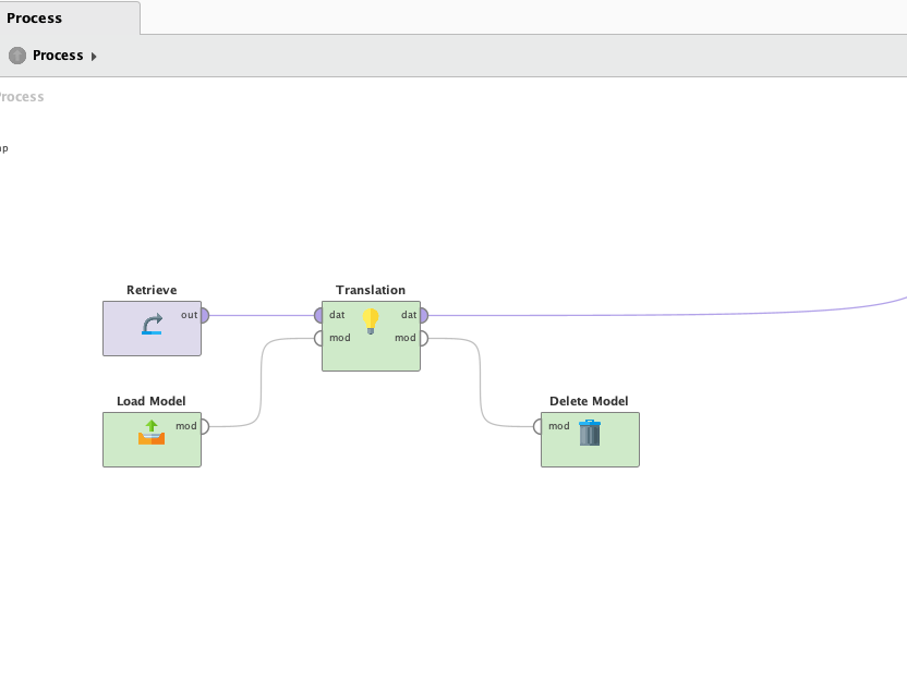

Hi all, I am running a small language model pilot using RapidMinder. This is on Macbook. My env throws an error. "datasets not found".  I have installed datasets in conda env.
Pls see image 1 - the model &
image 2 - error.
Conda is installed. datasets folder/ file is available. What I am missing?  Do I need to add anything to the path? if yes - how do I?
thanks,
Akash

    Hi @akash10,
    A couple of questions to help try and diagnose:
    1. Are you able to run any of of the tutorial processes?
    2. Which LLM are you using - just to test from my side?
    3. Can you display the list of Python packages in your conda environment (I assume called rm_genai)
    Best,
    Roland

    Hi @rjones13 thanks for getting back to me, really appreciate it.  Please note that I do not have an extensive background in Python. I am a PM lead and trying my hands with no-code AI ML Gen AI tools.
    A1) I can run several tutorials as well as other ML models that I am testing / building. I was trying my 1st lesson with small language model. The SML I am trying is a basic model for translation from Huggingface.
    Q2) I am trying Model Helsinki-NLP/opus-mt-en-hi
    A3) Package manager condo (anaconda)
    Path,
    bash-3.2$ echo $PATH
    /Applications/conda/anaconda3/bin:/Applications/conda/anaconda3/condabin:/usr/local/bin:/System/Cryptexes/App/usr/bin:/usr/bin:/bin:/usr/sbin:/sbin:/var/run/com.apple.security.cryptexd/codex.system/bootstrap/usr/local/bin:/var/run/com.apple.security.cryptexd/codex.system/bootstrap/usr/bin:/var/run/com.apple.security.cryptexd/codex.system/bootstrap/usr/appleinternal/bin
    I couldn’t or do not know the command to find env rm_genai and PATH variables.
    When I test rm_genai in Rampidminder, I see below and pic
    Python 3.10.8
    Brotli @ file:///Users/runner/miniforge3/conda-bld/brotli-split_1695989934239/work
    certifi @ file:///home/conda/feedstock_root/build_artifacts/certifi_1707022139797/work/certifi
    charset-normalizer @ file:///home/conda/feedstock_root/build_artifacts/charset-normalizer_1698833585322/work
    filelock @ file:///home/conda/feedstock_root/build_artifacts/filelock_1698714947081/work
    gmpy2 @ file:///Users/runner/miniforge3/conda-bld/gmpy2_1666808753481/work
    idna @ file:///home/conda/feedstock_root/build_artifacts/idna_1701026962277/work
    Jinja2 @ file:///home/conda/feedstock_root/build_artifacts/jinja2_1704966972576/work
    MarkupSafe @ file:///Users/runner/miniforge3/conda-bld/markupsafe_1706900061465/work
    mpmath @ file:///home/conda/feedstock_root/build_artifacts/mpmath_1678228039184/work
    networkx @ file:///home/conda/feedstock_root/build_artifacts/networkx_1698504735452/work
    numpy @ file:///Users/runner/miniforge3/conda-bld/numpy_1660673193545/work
    pandas==1.5.2
    Pillow @ file:///Users/runner/miniforge3/conda-bld/pillow_1695247237784/work
    PySocks @ file:///home/conda/feedstock_root/build_artifacts/pysocks_1661604839144/work
    python-dateutil @ file:///home/conda/feedstock_root/build_artifacts/python-dateutil_1626286286081/work
    pytz @ file:///home/conda/feedstock_root/build_artifacts/pytz_1706886791323/work
    requests @ file:///home/conda/feedstock_root/build_artifacts/requests_1684774241324/work
    six @ file:///home/conda/feedstock_root/build_artifacts/six_1620240208055/work
    sympy @ file:///home/conda/feedstock_root/build_artifacts/sympy_1684180540116/work
    torch @ file:///Users/runner/miniforge3/conda-bld/pytorch-recipe_1699115985439/work
    torchaudio==2.0.0
    torchvision @ file:///Users/runner/miniforge3/conda-bld/torchvision-split_1682949189328/work
    typing_extensions @ file:///home/conda/feedstock_root/build_artifacts/typing_extensions_1702176139754/work
    urllib3 @ file:///home/conda/feedstock_root/build_artifacts/urllib3_1708239446578/work

    rjones13  - I was able to fix the issue.
    Issues - Python version was not 3.11.5. I fixed the env, deleted rm_genai env and re-created env. All worked like a charm.
