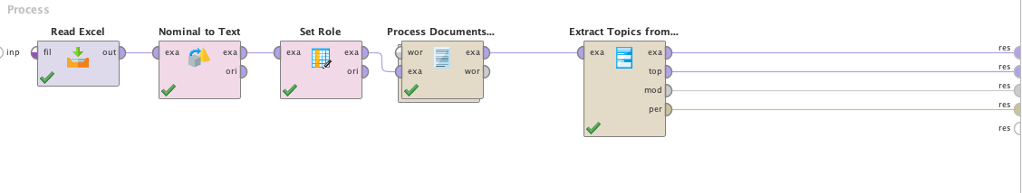

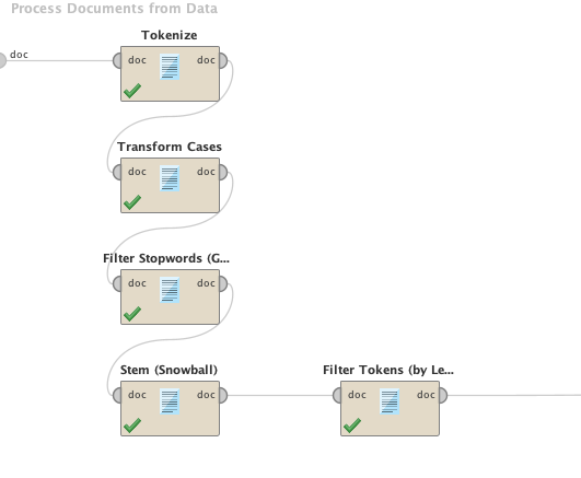

I´m trying to use LDA for a single Column in an Excel File, so the Read Excel Operator is currently only importing one Column into the software which is different texts in 400 rows. Currently I´m using the process shown in the pictures I attached below, as it is quiet similar to the process which is shown in a Youtube Tutorial by Nasir Soft called: "13 -Topic Modeling and Latent Dirichlet Allocation (LDA) | Twitter Mining | Rapidminer Tutorial". I´m not allowed to post Links yet, but I will attach his process also (it is the fourth picture).
I think the processes are quite similar except for the fact, that I´m using the "Process Documents" Operator to preprocess the text data (Tokenizing, Stemming...).
Does anybody know what I´m doing wrong as i dont get any results.

Hi there,
are you sure there is any text going in? It doesn't look to bad from the first look.

Hey,
check the output of the 'top' port. It tells you the most important words per topic, which is generally very helpful.
I wrote something about it years back on my blog: https://towardsdatascience.com/topic-mining-on-amazon-reviews-ae76fc286c61
Cheers,
Martin
