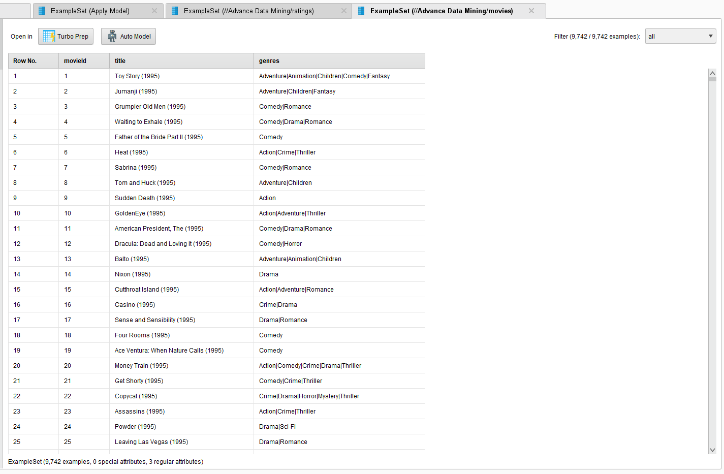

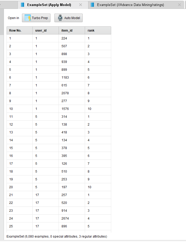

I use Rapidminner for Collaborative Filtering Item Recommendation with user k-nn  and the result at "item_id" is number like this
so how can I replace Movie Name (title) instead of item_id.
I try to use set role operator and set additional roles : attribute 'title' with 'item identification' but output is the same. the "item_id" still be number.

    Is the "item_id" the same as "movieId" in your other table? If so, I would use a join on the two tables using these two columns, and then optionally you can remove/rename columns to whatever output you need.

    Just as an update, I haven't come up with a solution right now. I've looked more into the extension, as there doesn't seem to be an immediate way to output it's mapping of item_id to the original titles. I found a website, but for now I don't seem to be able to access the workflow. I will keep investigating, and I may also see if we can come up with an alternative workflow in core operators which gets around this limitation.
