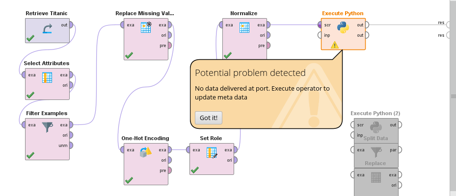

I used the Titanic data provided as sample data.
I plan to do simple preprocessing in RM and build the model using Execute python.
However, when I connect the data, this error appears.
Please help if there is a way to resolve this error.
Has anyone tried using taitanic data to build a model in Python after preprocessing in RM? If so please tell me how

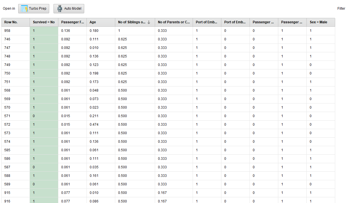

I captured the preprocessed data and error messages.

Thank you for your reply.
I tried that. I also watched the tutorial and tried it too.
But I guess the method of loading the data was wrong.
I will attach an image. Can you help me?

Rather than applying the data to the 'scr' input which is the script input, you should connect it to the 'inp' field. I'd recommend the tutorials for Execute Python to see this in action.
Best,
Roland
