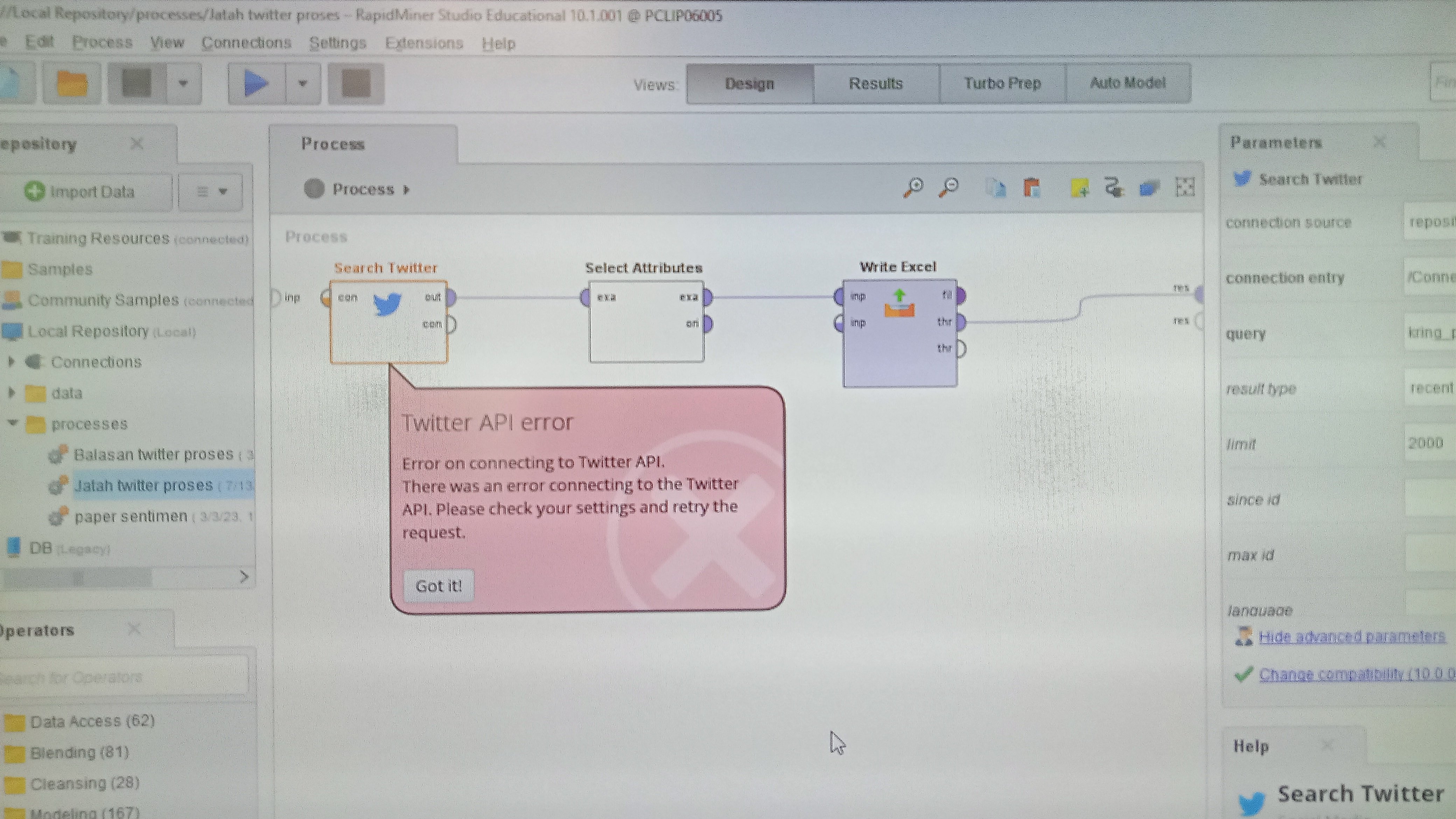

Twitter API error
New Altair Community Member
Updated by Jocelyn
I tried different Twitter connection, different PC and wifi connection, still doesn't work.
Is it related to new Twitter api policy?
I am using rapid miner 10.0 dan 10.1 with educational free licenses

Same issue here. Hope someone can shed light on this.

Im also facing the same issue. Has anyone been able to resolve it?
Hello everyone,
since X/Twitter changed it's API and corresponding policy, free reading access to X/Twitter no longer exists. This is also the reason why we deprecated the pre-built Twitter operators.
Like any other RESTful API, you can still access twitter using the operators from e.g. the Web Mining Extension.
See: Twitter API Documentation | Docs | Twitter Developer Platform
