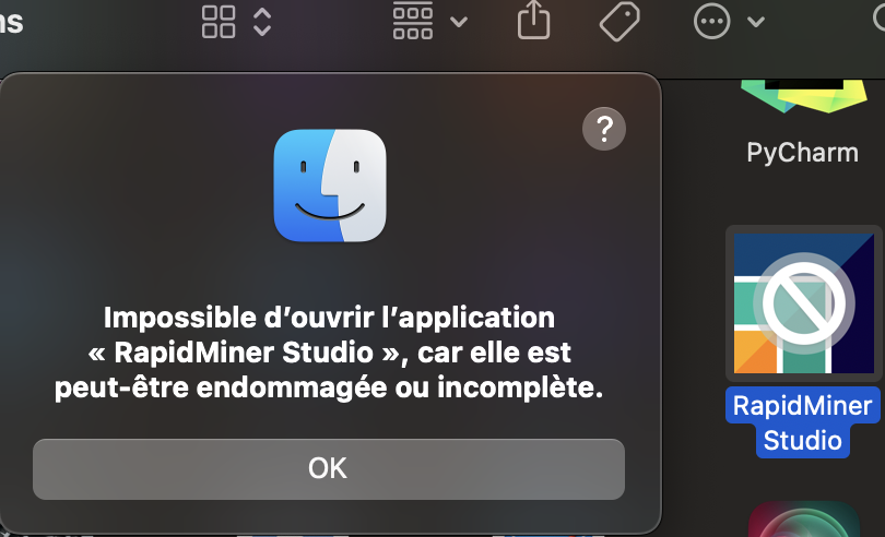

First of all, I can no longer open the application from the Mac's Applications menu. It says that the application is damaged or incomplete. I can still launch it with the shell file from my terminal, but I'd like to know what the problem is and how to solve it. I've deleted the application and downloaded it again, but the problem persists.

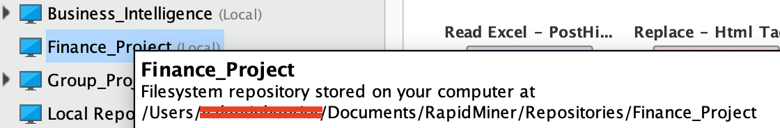

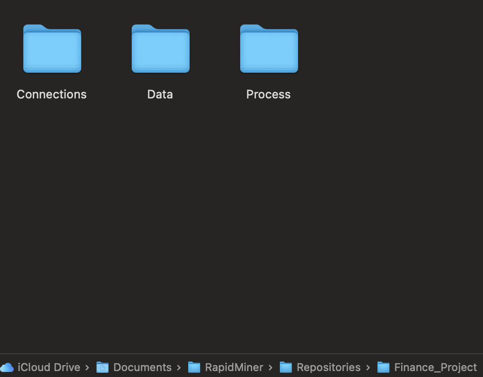

The second problem is that when I open RapidMiner Studio, I no longer have access to my files saved in the application. The saved processes no longer appear, even though the access paths are correct. As you can see in the example below, for the Finance_Project folder, the global directory is displayed on RapidMiner, but when I click on it, I can't access the subfolders containing the processes, data and connections, even though the path entered is the correct one. Everything worked perfectly before.

    Hi Valentine,
    I sadly don't have an arm mac on hand to reproduce the issues.
    But some things you could try:
    - Instead of putting the RapidMiner Studio App into Applications, try to install it onto your desktop
    - Right click on the RapidMiner Studio App and select "Get Info" in the Info window select "Open using Rosetta"
    For the charts issue when started from the terminal:
    RapidMiner Studio seem to start using a native mac-aarch64 Java installation, but we don't bundle mac-arm binaries yet. You could try to make it start using a mac-x64 Java 11 installation to force Rosetta 2 usage.
    Greetings,
    Jonas

    I've tried to totally de-install RapidMiner Studio including the .RapidMiner directory and re-install it again on my Desktop. The problem remains the same, I can't open the application directly and I have no option to open the application with Rosetta 2 (although the latter is installed on my Mac since I use it for certain applications).
    I also noticed that in the application files there was no exec file in the MacOs directory of the RapidMiner application. Could this be the problem? And if so, what can I do to solve this problem, bearing in mind that I've completely deleted all the RapidMiner files from my Mac and re-installed everything from scratch.
