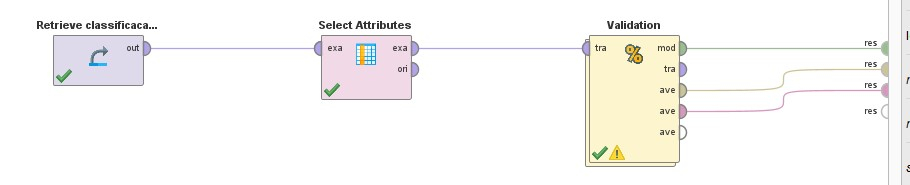

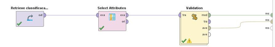

Currently, I have a simple model with a decision tree that looks like this:

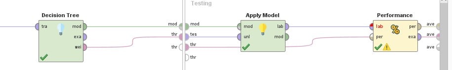

In my Split Validation, currently I have the following operators:

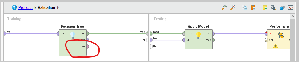

I want to get the "wei" from my decision tree, so that I can see the Feature Importance Table in the Results.
I tried this way:

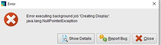

But it is throwing an error when I run it:
Do you recommend any workaround?

    Hi!
    Use the "Remember" operator to remember the weight result inside the validation and then "Recall" to get it outside the process.
    You could also store it in the repository (using Store) and retrieve (using Retrieve) later if you wanted to store it anyway.

    I don't think it would be because of the dataset... If I tried to get the "wei" from the decision tree outside the split validation operator I would be able to see the Feature Importance Table in the results.
    @BalazsBarany, your suggestion worked. Thanks a lot!
