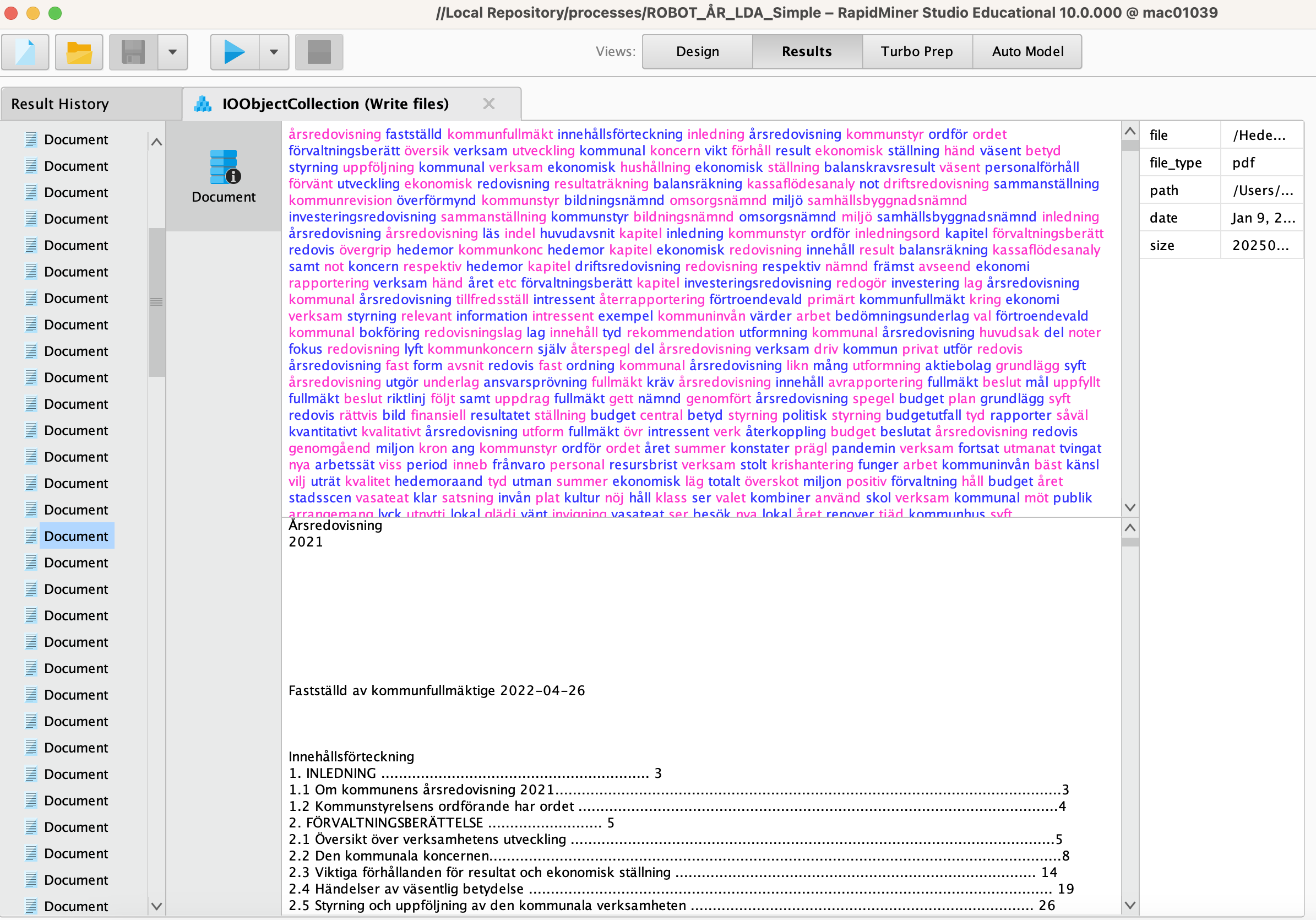

I have a couple of loop files operators to conduct a series of preprocessing steps on a corpus of annual reports documents (including tokenization, stemming, etc.). The last step is to write the preprocessed documents in text files using the "Write as text" operator. However, it writes the original text rather than the tokenized version (seen on the top half of my results view - see attached screenshot).
Thanks for the help!
/Aya
