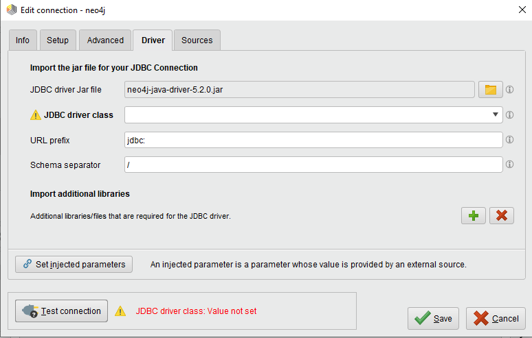

I am not able to connect Neo4j with Rapid Miner
Pooja_Agrawal
New Altair Community Member
Version of RM Studio - 9.9.002
Version of Neo4j - 5.2.0
Please help me with the steps to connect Neo4j with Rapid Miner.
Is there any extension that need to be downloaded?
What driver or jar file do I need? Because while using neo4j-java-driver-5.2.0. I am not able to get required driver class updated.
Thanks,
Pooja

I am also not getting "Manage Database Drivers" option under the Connection menu

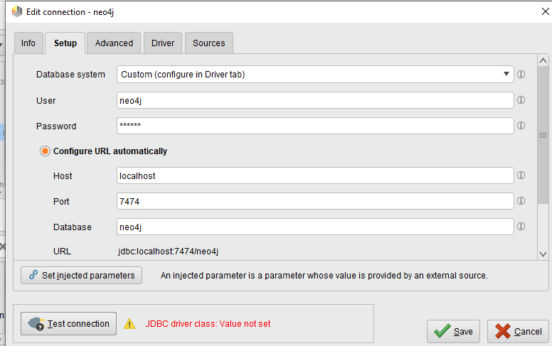

Hi Martin, Thank you for your response.
The issue got resolved by actually selecting the appropirate JDBC Driver jar file with respect to the Rapid Miner Studio Version installed.
Also, change the URL prefix from "jdbc:" to "jdbc:neo4j:bolt://"
use Port: 7687
I hope this helps.
Thanks,
Pooja1 -
