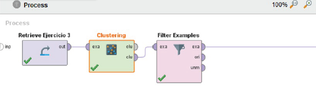

I'm newbie and I was reading some material, but i'm stuck on the filter that applies after a kmeans operator:
The book says that 'Filter Example' node, you will see something like this:

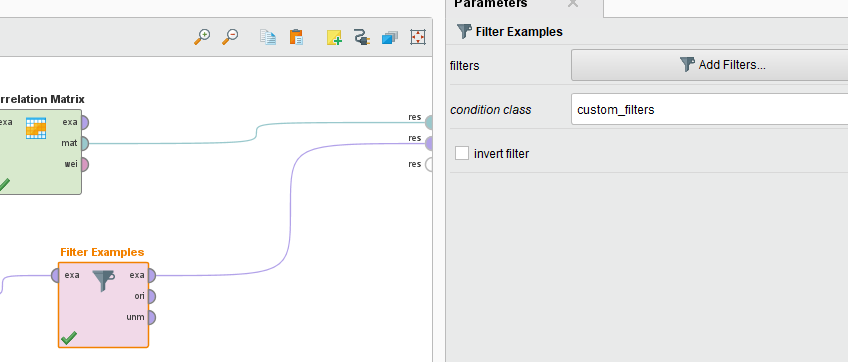

However, no matter how i apply the filters, the menu at right sides is different, without 'parameter string' field:
Does anyone knows why?

    So, in other words, the first screenshot is not longer available anymore?
    if you really really want to, you can change the operators comparability mode to 6.4. This option is on the very bottom of the parameter screen:
    This way you get back the old behavior and as you can see you can use attribute_value_filter.
    Anyhow, there is good reason why we deprecated this option in newer versions. So use this option with caution.
