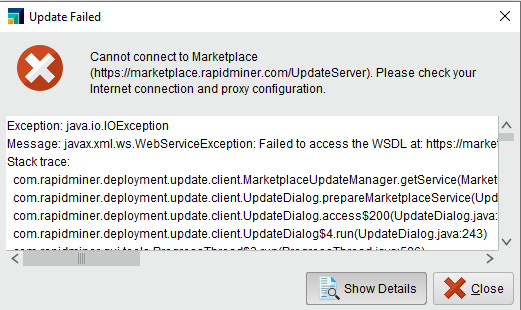

I downloaded Rapidminer today as student and i was asked to download the Text Mining module / Text Processing extension, however, I have the error below which doesn't have to do with my internet connection:

You can put the manually downloaded extension into your $HOME/.RapidMiner/extensions folder. $HOME is probably something like C:\Users\yourname on Windows and /home/yourname on MacOS or Linux.

Thank you !, that solution worked perfectly1
