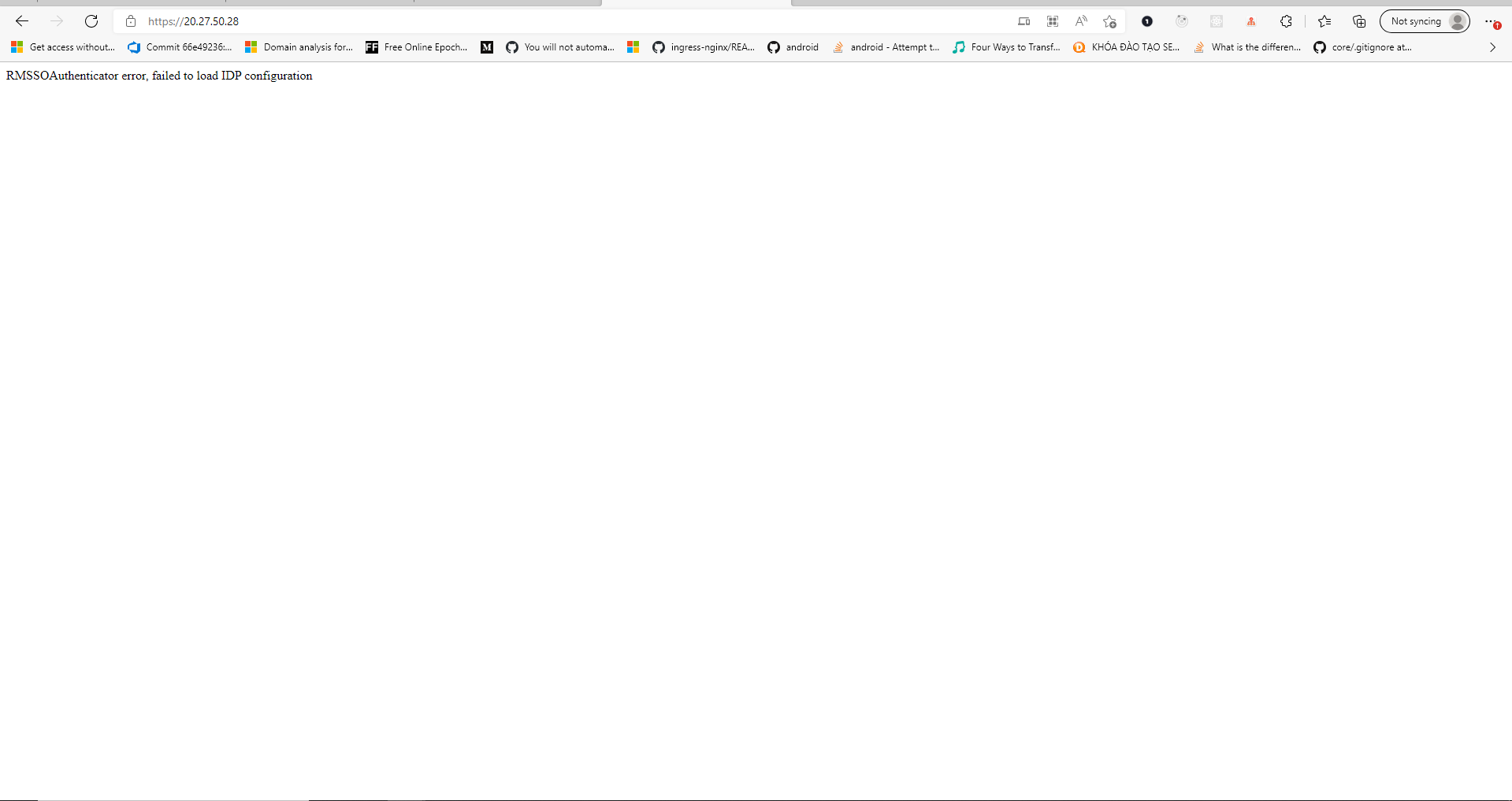

And then I redeployed . However, an error occurred when accessing RapidMiner AI Hub:
"RMSSOAuthenticator error, failed to load IDP configuration"

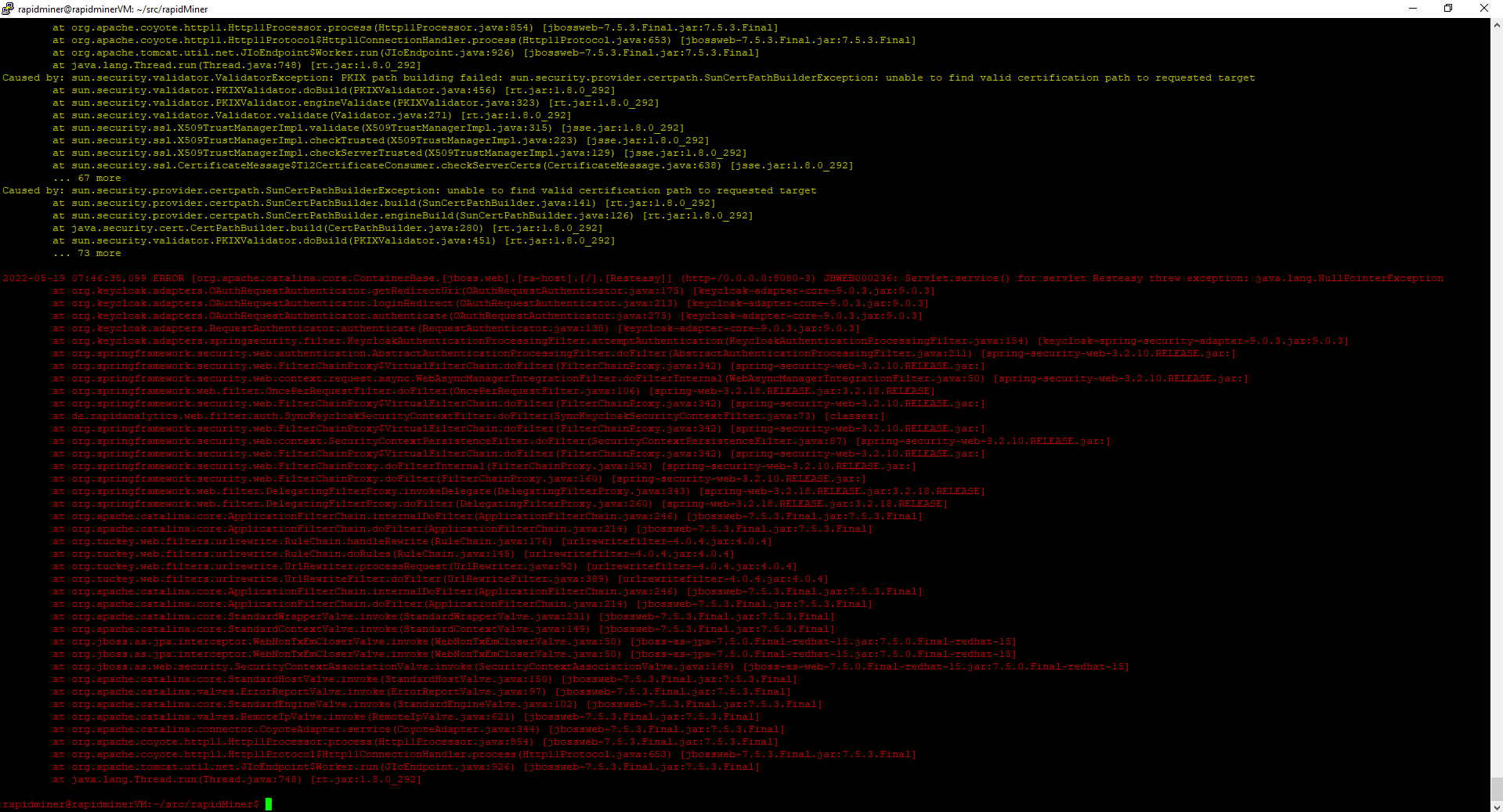

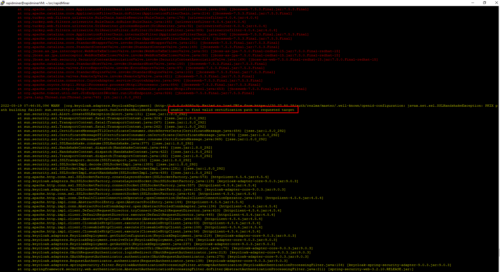

I tried looking in the logs of the rapidminer-server container and the following warning appeared
Please show me the correct way to get SSL to make Https connection.
