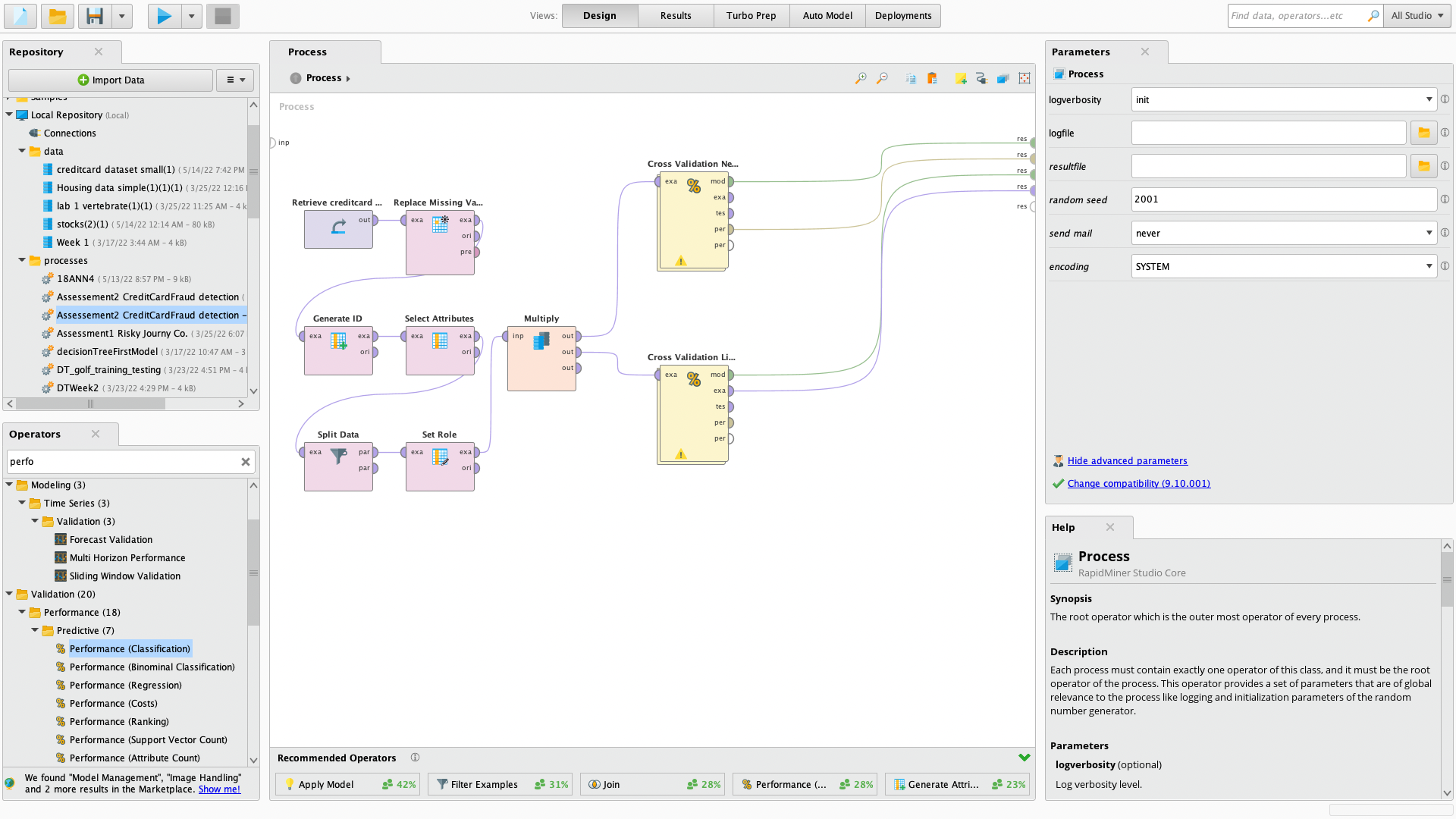

Here is the process i have come up with
Linear regression model
Neural Net
Struggling so bad so can anyone please help asap, please. It cannot even run as it is saying: "non-nominal label". Performance (classification) cannot handle numerical label. Can any one please help

    Hi!
    I don't see your label in the screenshot. What kind of attribute is it? The modeling algorithms and also the Performance operator need to match the label's type.
    You should do Set Role before the cross validation, not inside it. The Performance operator needs to have both the prediction and the label attributes, but if you do it only in Training, it won't be applied in Testing.

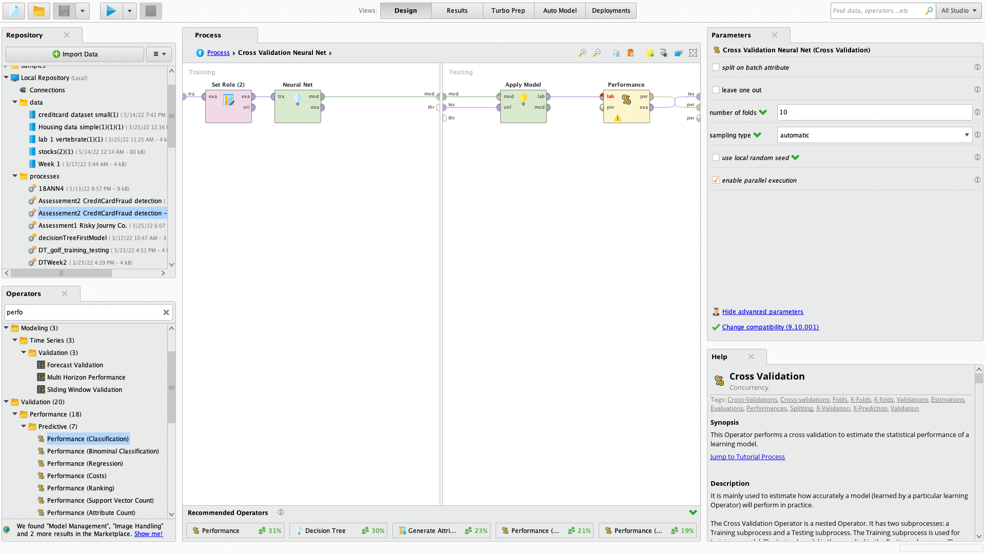

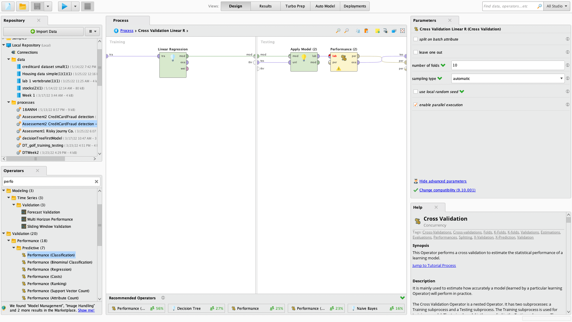

  • Andr3w_j_A
    Andr3w_j_A New Altair Community Member
    Thank you for the reply. Here are the changes I implemented
