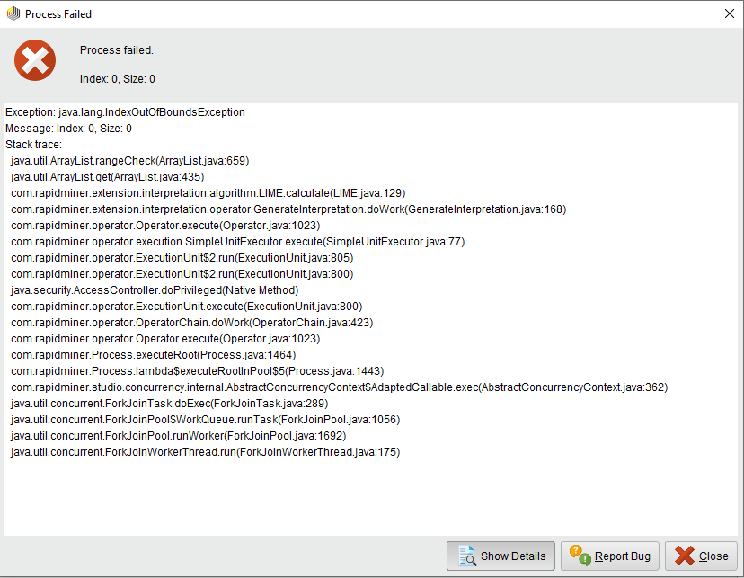

I am trying to use Generate Interpretation operator with Python learner but it keeps give me this Exception, I have tried several models in the Python code such as SVM and GausianMixture.
Also the Log shows this warning "Custom Python Learner: The number of regular attributes of the given example set does not fit the number of attributes of the training example set, training: 7, application: 8". Maybe this warnig and IndexOutOfBoundsException are related.
The Apply Model operator works well with the Python Learner, also I am sure that the number of attributes are all the same, and I tried to remove the label to see if there is a difference, but the same error apears when using Generate Interpetation.
What could be the problem is?

    the line failing is the line were we try to find the confidence column after scoring. Does your python script provide confidences or only predictions?
    Can you maybe provide an example for it? This is either a bug or we need a proper error message here.
