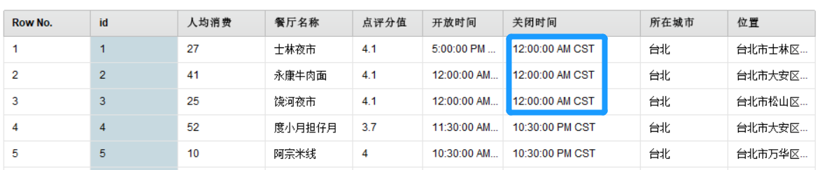

Hi dears
I've struggled to change a certain of time value for almost one day, which is turning the "12:00:00 AM" into "12:00:00 PM", I 've used "Date to nominal" to deal with it, but after doing so the time value would be changed, so I gave up this method.
Now I am trying to use "Generate Macro", but I have no idea how to write the function expression, could you please tell me?
Sincerely,
Starfish

    Hi @Starfish
    you can use the Generate Attributes to create a new attribute and use an if statement with  date_get method and DATE_UNIT_HOUR to extract the date hour, compare it with your target value and replace it with the  new value.
    if(date_get([Date], DATE_UNIT_HOUR)==9,(date_set([Date],10, DATE_UNIT_HOUR )),date_get([Date], DATE_UNIT_HOUR))
