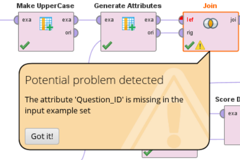

I'm getting an Attribute Missing Error for a Join operator:

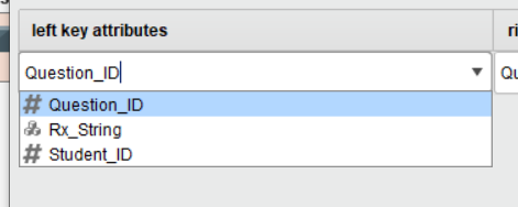

However, the attribute is definitely there:

PS.  I tried setting the role before and after the De-Pivot that came earlier.  Nothing happened.  I tried generating a new attribute called Question_ID based on the Question_ID that already exists.  No help.

    Hi,
    Pivot, De-Pivot and Transpose is the other main source. Since every operator only knows the schema, and not the content it cannot calculate the resulting schema for such operations.

    this is only a problem, not an error. It occurs because one of the previous operators, does not report that the left hand side key attribute is in the data set. Commonly the cause is a Read Excel or Read CSV operator, where you did not use the import wizard but configured the operator manually.

    Hi Martin,
    Nope.  I did use the Wizard.  There was no problem until I used the De-Pivot operator.  After that, it stopped recognizing the attribute.
    K

    Hi,
