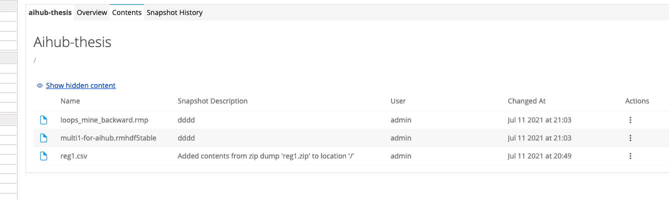

Below is my file listing. Showing in case this helps to direct me to how to access the data I am trying to use.
Any advice will be appreciated.
Thank you.
