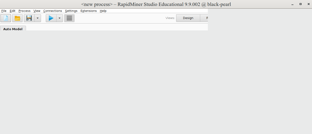

My rapidminer stops working and becomes freeze, as a result I cant get any outputs. I have checked my ram, cpu, and all other things work properly. Linux Ubuntu 20.04 64 bit, 12 G byte of Ram, i7 core processor, GTX 850m graphics. I have downloaded the latest version of RP today and it was the same.
300*12 csv file with auto model build was used.
Let me add some info to the question
This is a screenshot of the time that my model ended. It freezes just here. No resources is being used now and it just stops working.
This is the last few lines of Terminal:
Also, this is what happens if I try to do anything with it.
These are some results of my configuration:

Use the resource screen, this helps you to get an idea of where things go wrong. Start your process and use many stoppoints, on each stop look at memory consumption. If you see a problem sudden increase optimise the previous step.
If you have loops an parallel processing, try without first. If you have filters use the 'remove unused...' right after your filter operator to get rid of unnecessary clutter.
12GB is on the low side, but should be enough. Also, in your settings limit the total amount of memory RM can use. Say like 6GB, so you ensure the rest of your machine has some resources when needed. RM tends to take whatever it can, which is not the same as what it needs. I had the same on ubuntu.
Also, make use of thd release memory and materialize data operators after heavy transformation parts, this also has a positive impact on memory consumption.0 -
