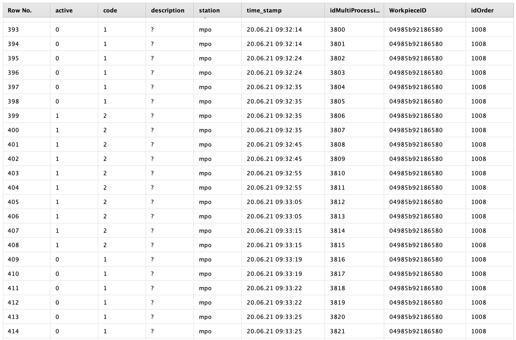

Hello everybody,
I want to calculate the production time of a machine per order (idOrder). There are a total of 53 orders.
In this example, I have to subtract the time of line number 408 from 399, since the machine was active at that time.
Can you tell me how I calculate the production time?
Best regards and thank you very much
Max
