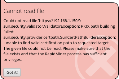

Im trying to to use the Read URL function, and it can connect to any traditional website, however, I am trying to read from an arduino server. 192.168.x.x. Ive added certificates so when accesses the server site the page is secure, however, when I try to read the URL I get this error.
I'm very new to all of this, so I really don't even know where to begin looking for the solution.

OPIt seems I found the problem pretty quickly after posting. The contents of the trust certificates documentation fixed my problems for me.
