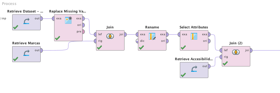

I am trying to use several join operators to be able to make 1 to n relationships from several tables created previously.
That join seems to have only the new table Accessibility and the previously selected attributes.
The weird thing is that I have not selected Id_Marcas, anywhere and it appears alone.
Where I have the box Rename, I have renamed id to id_marcas, as I am going to do many joins afterward. I don't get the point of reusing the column as there are different joins with different attributes and tables.
Thank you
Thank you

these are the images of the process with the breakpoints.
Original process
After the replacing the null or inexistent values

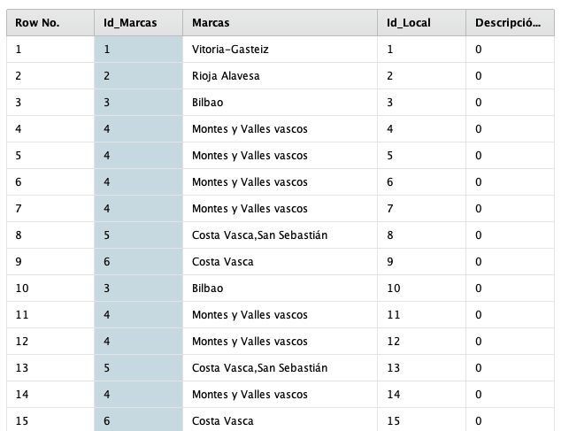

The "marcas" table after "Id" column changes its name to "Id_Marcas"
The result of the first join
Result after selecting the valid attributes
The result after the 2nd join
Where has the id of accessibility gone?
Composition of the join
Thank you soo much

<?xml version="1.0" encoding="UTF-8"?><process version="9.9.000"> <context> <input/> <output/> <macros/> </context> <operator activated="true" class="process" compatibility="9.9.000" expanded="true" name="Process"> <parameter key="logverbosity" value="init"/> <parameter key="random_seed" value="2001"/> <parameter key="send_mail" value="never"/> <parameter key="notification_email" value=""/> <parameter key="process_duration_for_mail" value="30"/> <parameter key="encoding" value="SYSTEM"/> <process expanded="true"> <operator activated="true" class="retrieve" compatibility="9.9.000" expanded="true" height="68" name="Retrieve Marcas" width="90" x="45" y="136"> <parameter key="repository_entry" value="Marcas"/> </operator> <operator activated="true" class="retrieve" compatibility="9.9.000" expanded="true" height="68" name="Retrieve Dataset - ETL" width="90" x="45" y="34"> <parameter key="repository_entry" value="Dataset - ETL"/> </operator> <operator activated="true" class="replace_missing_values" compatibility="9.9.000" expanded="true" height="103" name="Replace Missing Values" width="90" x="179" y="34"> <parameter key="return_preprocessing_model" value="false"/> <parameter key="create_view" value="false"/> <parameter key="attribute_filter_type" value="all"/> <parameter key="attribute" value="Descripción del Icono de Accesibilidad"/> <parameter key="attributes" value=""/> <parameter key="use_except_expression" value="false"/> <parameter key="value_type" value="attribute_value"/> <parameter key="use_value_type_exception" value="false"/> <parameter key="except_value_type" value="time"/> <parameter key="block_type" value="attribute_block"/> <parameter key="use_block_type_exception" value="false"/> <parameter key="except_block_type" value="value_matrix_row_start"/> <parameter key="invert_selection" value="false"/> <parameter key="include_special_attributes" value="true"/> <parameter key="default" value="value"/> <list key="columns"/> <parameter key="replenishment_value" value="0"/> </operator> <operator activated="true" class="retrieve" compatibility="9.9.000" expanded="true" height="68" name="Retrieve Accesibilidad" width="90" x="447" y="187"> <parameter key="repository_entry" value="Accesibilidad"/> </operator> <operator activated="false" class="retrieve" compatibility="9.9.000" expanded="true" height="68" name="Retrieve Calidad" width="90" x="916" y="442"> <parameter key="repository_entry" value="Calidad"/> </operator> <operator activated="false" class="retrieve" compatibility="9.9.000" expanded="true" height="68" name="Retrieve Capacidad" width="90" x="1050" y="493"> <parameter key="repository_entry" value="Capacidad"/> </operator> <operator activated="false" class="retrieve" compatibility="9.9.000" expanded="true" height="68" name="Retrieve CPostal" width="90" x="1184" y="544"> <parameter key="repository_entry" value="CPostal"/> </operator> <operator activated="false" class="retrieve" compatibility="9.9.000" expanded="true" height="68" name="Retrieve Municipio" width="90" x="1318" y="595"> <parameter key="repository_entry" value="Municipio"/> </operator> <operator activated="false" class="retrieve" compatibility="9.9.000" expanded="true" height="68" name="Retrieve Plantilla" width="90" x="1452" y="646"> <parameter key="repository_entry" value="Plantilla"/> </operator> <operator activated="false" class="retrieve" compatibility="9.9.000" expanded="true" height="68" name="Retrieve Tipo" width="90" x="1586" y="697"> <parameter key="repository_entry" value="Tipo"/> </operator> <operator activated="true" class="blending:rename" compatibility="9.9.000" expanded="true" height="82" name="Rename" width="90" x="179" y="136"> <list key="rename attributes"> <parameter key="id" value="Id_Marcas"/> </list> <parameter key="from_attribute" value=""/> <parameter key="to_attribute" value=""/> </operator> <operator activated="true" class="concurrency:join" compatibility="9.9.000" expanded="true" height="82" name="Join" width="90" x="313" y="85"> <parameter key="remove_double_attributes" value="true"/> <parameter key="join_type" value="inner"/> <parameter key="use_id_attribute_as_key" value="false"/> <list key="key_attributes"> <parameter key="Marcas" value="Marcas"/> </list> <parameter key="keep_both_join_attributes" value="false"/> </operator> <operator activated="true" breakpoints="after" class="select_attributes" compatibility="9.9.000" expanded="true" height="82" name="Select Attributes" width="90" x="447" y="85"> <parameter key="attribute_filter_type" value="subset"/> <parameter key="attribute" value=""/> <parameter key="attributes" value="Id_Local|Id_Marcas|Marcas|Descripción del Icono de Accesibilidad"/> <parameter key="use_except_expression" value="false"/> <parameter key="value_type" value="attribute_value"/> <parameter key="use_value_type_exception" value="false"/> <parameter key="except_value_type" value="time"/> <parameter key="block_type" value="attribute_block"/> <parameter key="use_block_type_exception" value="false"/> <parameter key="except_block_type" value="value_matrix_row_start"/> <parameter key="invert_selection" value="false"/> <parameter key="include_special_attributes" value="false"/> </operator> <operator activated="true" breakpoints="after" class="concurrency:join" compatibility="9.9.000" expanded="true" height="82" name="Join (2)" width="90" x="581" y="136"> <parameter key="remove_double_attributes" value="true"/> <parameter key="join_type" value="inner"/> <parameter key="use_id_attribute_as_key" value="false"/> <list key="key_attributes"> <parameter key="Descripción del Icono de Accesibilidad" value="Descripción del Icono de Accesibilidad"/> </list> <parameter key="keep_both_join_attributes" value="false"/> </operator> <operator activated="false" breakpoints="before" class="blending:rename" compatibility="9.9.000" expanded="true" height="82" name="Rename (2)" width="90" x="782" y="340"> <list key="rename attributes"> <parameter key="id" value="Id_Accesibilidad"/> </list> <parameter key="from_attribute" value=""/> <parameter key="to_attribute" value=""/> </operator> <operator activated="false" class="select_attributes" compatibility="9.9.000" expanded="true" height="82" name="Select Attributes (2)" width="90" x="916" y="340"> <parameter key="attribute_filter_type" value="subset"/> <parameter key="attribute" value=""/> <parameter key="attributes" value="Capacidad|Código municipio|Código país|Código provincia|Descripción|Descripción del Icono de Calidad|Dirección|Email|Id_Calidad|Id_Local|Id_Marcas|LATWGS84|Localidad|LONWGS84|Municipio|Nombre|País|Postal Code|Provincia|Teléfono|Tipo de Plantilla|Tipo de Restauración|WEB"/> <parameter key="use_except_expression" value="false"/> <parameter key="value_type" value="attribute_value"/> <parameter key="use_value_type_exception" value="false"/> <parameter key="except_value_type" value="time"/> <parameter key="block_type" value="attribute_block"/> <parameter key="use_block_type_exception" value="false"/> <parameter key="except_block_type" value="value_matrix_row_start"/> <parameter key="invert_selection" value="false"/> <parameter key="include_special_attributes" value="false"/> </operator> <operator activated="false" breakpoints="after" class="concurrency:join" compatibility="9.9.000" expanded="true" height="82" name="Join (3)" width="90" x="1050" y="391"> <parameter key="remove_double_attributes" value="true"/> <parameter key="join_type" value="left"/> <parameter key="use_id_attribute_as_key" value="false"/> <list key="key_attributes"> <parameter key="Descripción del Icono de Calidad" value="Descripción del Icono de Calidad"/> </list> <parameter key="keep_both_join_attributes" value="false"/> </operator> <operator activated="false" class="concurrency:join" compatibility="9.9.000" expanded="true" height="82" name="Join (4)" width="90" x="1184" y="442"> <parameter key="remove_double_attributes" value="true"/> <parameter key="join_type" value="left"/> <parameter key="use_id_attribute_as_key" value="false"/> <list key="key_attributes"> <parameter key="Capacidad" value="Capacidad"/> </list> <parameter key="keep_both_join_attributes" value="false"/> </operator> <operator activated="false" class="concurrency:join" compatibility="9.9.000" expanded="true" height="82" name="Join (5)" width="90" x="1318" y="493"> <parameter key="remove_double_attributes" value="true"/> <parameter key="join_type" value="left"/> <parameter key="use_id_attribute_as_key" value="false"/> <list key="key_attributes"> <parameter key="Postal Code" value="Postal Code"/> </list> <parameter key="keep_both_join_attributes" value="false"/> </operator> <operator activated="false" class="concurrency:join" compatibility="9.9.000" expanded="true" height="82" name="Join (6)" width="90" x="1452" y="544"> <parameter key="remove_double_attributes" value="true"/> <parameter key="join_type" value="left"/> <parameter key="use_id_attribute_as_key" value="false"/> <list key="key_attributes"> <parameter key="Municipio" value="Municipio"/> </list> <parameter key="keep_both_join_attributes" value="false"/> </operator> <operator activated="false" class="concurrency:join" compatibility="9.9.000" expanded="true" height="82" name="Join (7)" width="90" x="1586" y="595"> <parameter key="remove_double_attributes" value="true"/> <parameter key="join_type" value="left"/> <parameter key="use_id_attribute_as_key" value="false"/> <list key="key_attributes"> <parameter key="Tipo de Plantilla" value="Tipo de Plantilla"/> </list> <parameter key="keep_both_join_attributes" value="false"/> </operator> <operator activated="false" class="concurrency:join" compatibility="9.9.000" expanded="true" height="82" name="Join (8)" width="90" x="1720" y="646"> <parameter key="remove_double_attributes" value="true"/> <parameter key="join_type" value="left"/> <parameter key="use_id_attribute_as_key" value="false"/> <list key="key_attributes"> <parameter key="Tipo de Restauración" value="Tipo de Restauración"/> </list> <parameter key="keep_both_join_attributes" value="false"/> </operator> <connect from_op="Retrieve Marcas" from_port="output" to_op="Rename" to_port="example set input"/> <connect from_op="Retrieve Dataset - ETL" from_port="output" to_op="Replace Missing Values" to_port="example set input"/> <connect from_op="Replace Missing Values" from_port="example set output" to_op="Join" to_port="left"/> <connect from_op="Retrieve Accesibilidad" from_port="output" to_op="Join (2)" to_port="right"/> <connect from_op="Retrieve Calidad" from_port="output" to_op="Join (3)" to_port="right"/> <connect from_op="Retrieve Capacidad" from_port="output" to_op="Join (4)" to_port="right"/> <connect from_op="Retrieve CPostal" from_port="output" to_op="Join (5)" to_port="right"/> <connect from_op="Retrieve Municipio" from_port="output" to_op="Join (6)" to_port="right"/> <connect from_op="Retrieve Plantilla" from_port="output" to_op="Join (7)" to_port="right"/> <connect from_op="Retrieve Tipo" from_port="output" to_op="Join (8)" to_port="right"/> <connect from_op="Rename" from_port="example set output" to_op="Join" to_port="right"/> <connect from_op="Join" from_port="join" to_op="Select Attributes" to_port="example set input"/> <connect from_op="Select Attributes" from_port="example set output" to_op="Join (2)" to_port="left"/> <connect from_op="Join (2)" from_port="join" to_port="result 1"/> <connect from_op="Rename (2)" from_port="example set output" to_op="Select Attributes (2)" to_port="example set input"/> <connect from_op="Select Attributes (2)" from_port="example set output" to_op="Join (3)" to_port="left"/> <connect from_op="Join (3)" from_port="join" to_op="Join (4)" to_port="left"/> <connect from_op="Join (4)" from_port="join" to_op="Join (5)" to_port="left"/> <connect from_op="Join (5)" from_port="join" to_op="Join (6)" to_port="left"/> <connect from_op="Join (6)" from_port="join" to_op="Join (7)" to_port="left"/> <connect from_op="Join (7)" from_port="join" to_op="Join (8)" to_port="left"/> <portSpacing port="source_input 1" spacing="0"/> <portSpacing port="sink_result 1" spacing="0"/> <portSpacing port="sink_result 2" spacing="0"/> </process> </operator> </process>
I want to do a simple join as in sql, I am trying to normalize the data until I get the 3rd normal form. To do so, I am taking all the data from excel and I have splitted all the possible tables following the rules. Now, I am trying to link all the data of the different tables into the main table with all the attributes. For so I need to get all the primary keys, the ones I am trying to add to the main table with the joins.

Hi @ceaperez
I know, i have an attribute called id. Even so, i change the name with a box called rename attribute to try that way not to overwrite the data i have. The point is that i don't know what is happening because the join doesn't give me the new id joined at the second join.
