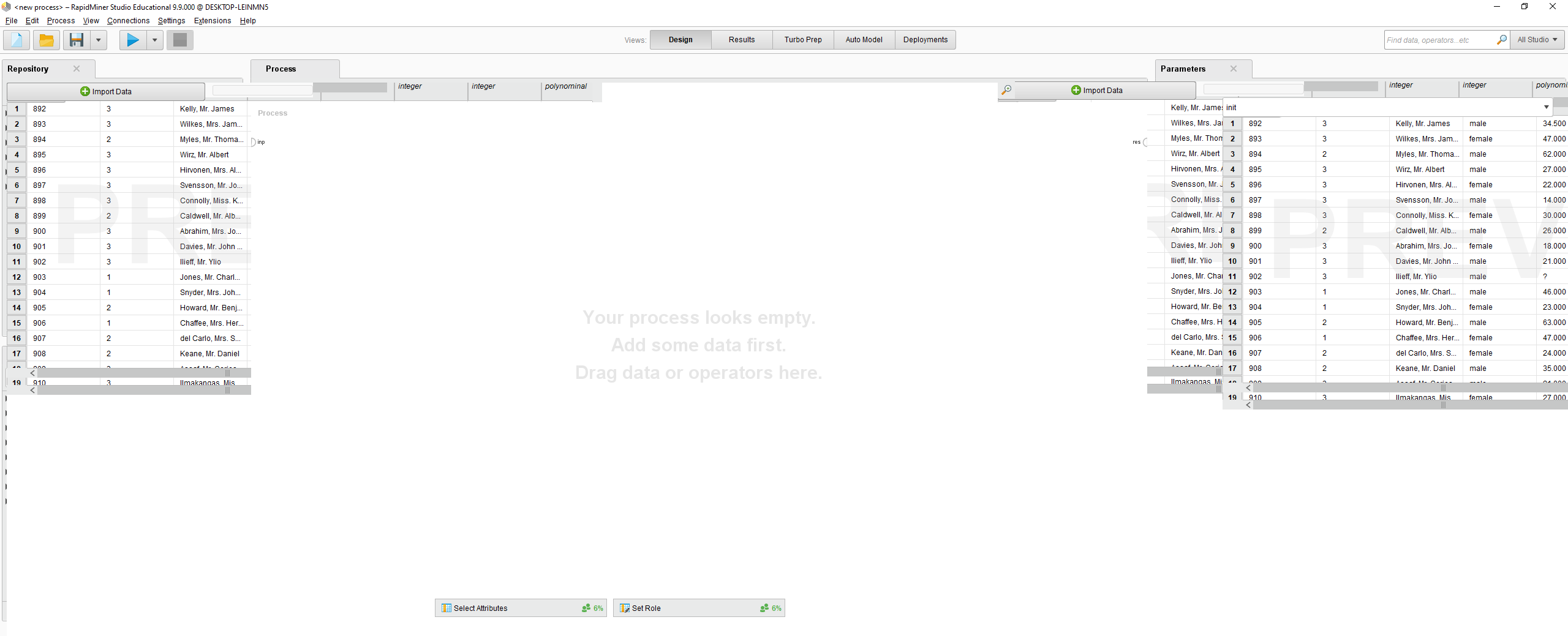

I am currently using RapidMiner 9.9 and have encountered GUI problems. During my work in program I get something like this.
